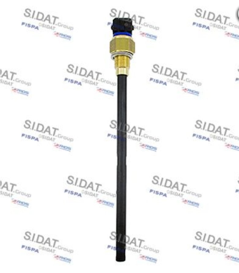

I have a faulty electronic oil level sensor on my 2010 1.5 dci clio.
Does anyone know the location of this sensor and if you know if this is a dealership part only.

Found it
The sensor is screwed into the bottom of the engine block front at the gearbox side. It has a 2 pin electrical connection which needs to be un-cliped before attempting to un-screw the sensor. It's a tight squeeze with a 19mm open ended spanner as there is not much room between the sensor and the back of the radiator. Also water hoses get in the way. I had to go in at a steep angle to try and get the spanner on to the sensor to loosen it. Hope this helps someone.
