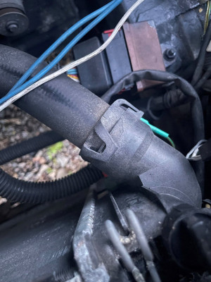

Re: Peugeot 405 coolant type
Another question on this, I'm a complete newbie here!
The top and bottom radiator hoses, do I need to twist to release them or use a flathead screwdriver to lift up the locking tabs: Cheers,
John
