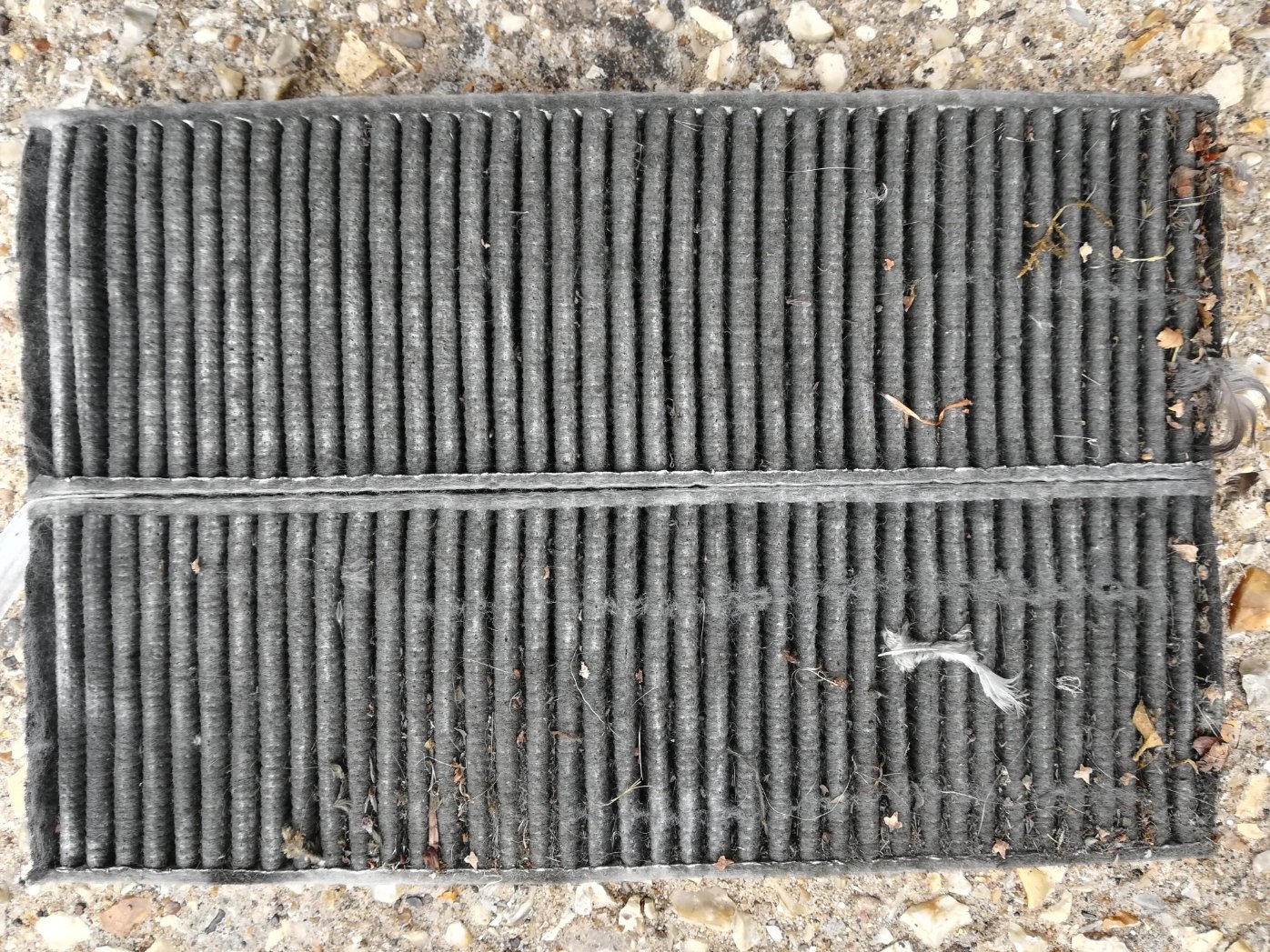

I know how much of a pain it is to change the pollen/cabin filter on many Peugeot/Citroen/DS cars and vans, due to the way you have to post it in two halves through a tiny slot that's jammed behind the steering column.
Just done mine today - bought car recently, 6 years old, 67k miles, main dealer service history until 46k. This is the filter I removed...
This was in addition to the many bits that fell into the footwell as I removed it. I suppose it could be legitimately 3 years if it wasn't due on the last service. I don't have any invoices, just the stamps in the book so I don't know what they charged for. Its service last year was just an oil and oil filter change at an indie garage. I'll have everything that's due done in the autumn, including the engine air filter that I'll leave for now.
I'm seriously wondering if it's the original one though - do they really get changed?!
Yuck. This is what you're breathing through.

I can see it has some leaves etc. in it, but I've changed worse! I agree - seems real service centers don't change them - only we home tinkerers...

You can't really see that well on the photos, but some of the pleats are full to the brim, presumably in the area where the air comes into the box. Lots showered out too, I tried to hoover out the box but couldn't manoeuvre the nozzle fully in. Will have to make a flexi nozzle next time, the new one was really tight to get the second section in, so it's likely that it's sitting on some rubbish in the bottom, hopefully this won't find its way into the system.
Whoever designed this housing should have been sent back to the drawing board. Perhaps it's less ridiculous on LHD cars where there's no steering column. I really don't see the need for having it in two sections, surely they could have made the slot twice as tall. The new filter had just enough strength to push in without buckling, but it was a bit tricky at times.

They will change these depending on which scheduled service is being undertaken. In the case of your DS5, it is every 40k miles or 2 years.

I'm going to return to what I did in the past, which is to pay a garage for doing anything oily and do the air and pollen filters myself. The main reason not being to save a few quid but just so I know it's been done and done carefully.
From the intervals then it would have got a new filter two years ago, when it was its fourth birthday. I can't say for sure, but this looks like more than two years / 20k miles worth of muck. More like 4 years or even the 6 since the car was built.
I've previously taken one out of the Berlingo (same filter/housing) that had been stuffed in carelessly so it buckled, with the result that it had a gap where the air could go straight past it. Not good for the air con system.
Will definitely find a way of hoovering out the bottom of the box the next time, if the slot was full height you could just scrape it out but the bonkers design means that's not possible. This design of filter housing needs a lot of care, the curve required to get around the obstructions is just at the limit of what the filter can take before it folds up.

On the DS5, I believe there are a pair of 2 filters and these are on the right hand side of the car (UK Driver's side), where on the X7 they are on the passenger side and there is only one large one.
@DeuxChevaux: Yes a dealer will only do what is required at the specific scheduled service and newer cars don't have everything changed at each service. - so the diesel fuel filter is only changed at a particular service interval / time frame, as is the pollen and air filters. Brake fluid is usually every 2 years.
