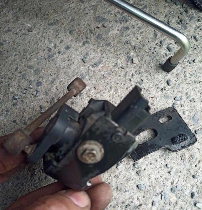

I took out the sensor, not easy job. It appears to be fine. 90deg working range 0.3V to 4.2V outputs tested on the second plug (not the sensor one). It is unlikely that the wire to the suspension control unit is broken, My next step is to check the relay 1524, I have following questions:

It was F01, I could not find the relay 1524 - it is shown on 2 diagrams E & H.
To put back the front height sensor
I had to cut out a piece of its bracket that holds the connector. It was then possible to mount it back.
thanks for help and the drawings . It was very helpful to narrow the searching.
It is much easier
- to disconnect and connect again the small push in arm to the clamp rather thane the sensor.
- to take out the bracket and mount the sensor outside then attach the arm and put the bracket in its place.
It is much easier
