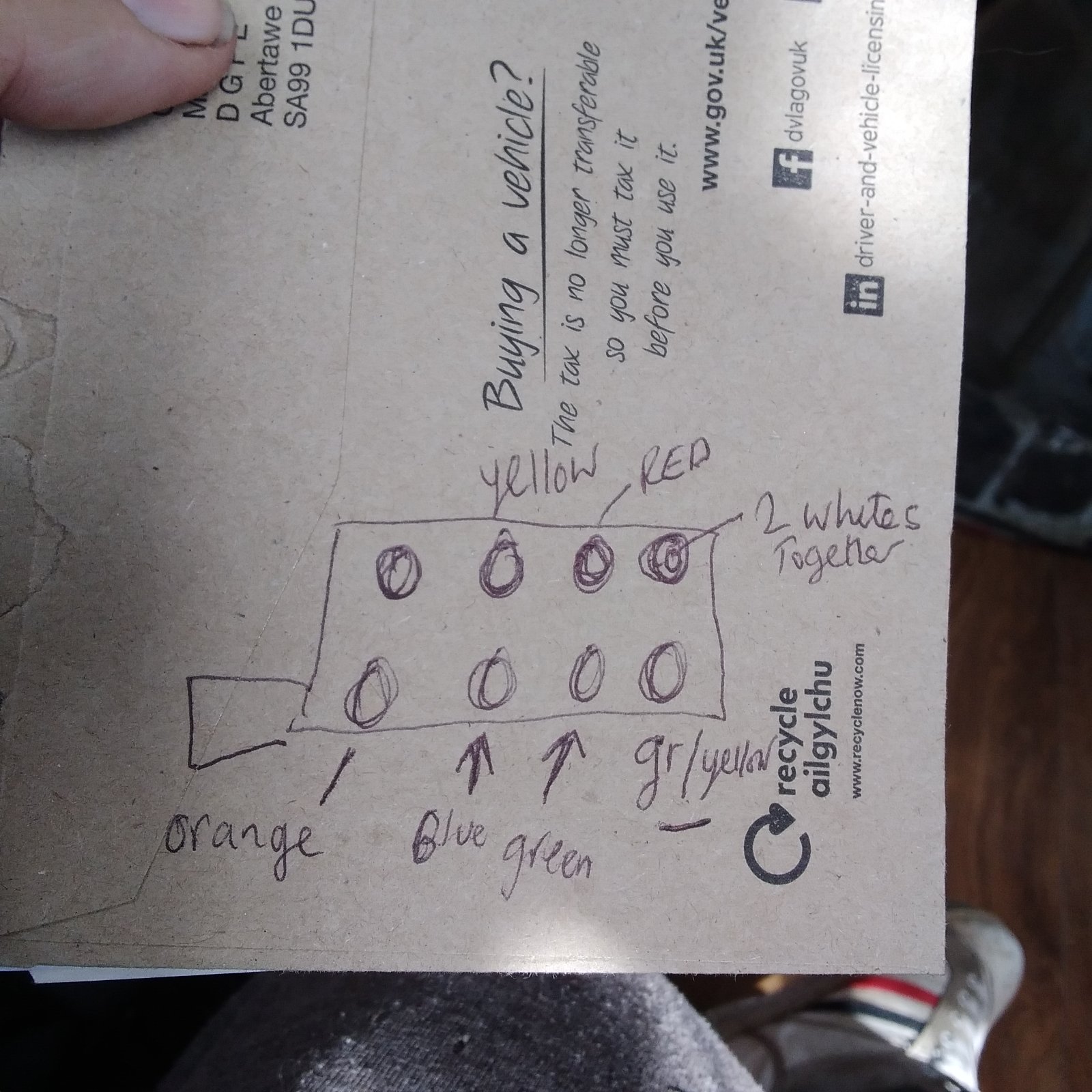

Thank you Marc for your help in this what was very confusing to me, what i did was cross reference all you and others gave and made a rough drawing as seen in an earlier post of mine i then found a 206cc being broken for parts contacted the seller it had the same music system they sent photos of both plugs for the cd player and i then checked with my rough drawing it looked good so i went for it and hey presto it worked ,
So many thanks for all help with this very tough for me to do as im no electrician with out the help from here id of been very lost.
