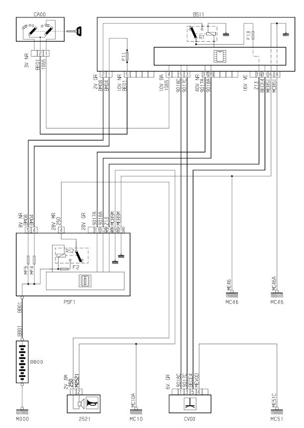

Hello,
my name is andre
This is my first post.
If I'm unlucky, I'll have to pull a new cable for the horn.
Berlingo 2 Bj. 2009 Diesel (DV6)
The horn doesn't work, but you can hear the relay clicking. My free workshop said that they had tested the horn alone last fall. Since then we're driving without the horn, but the TÜV is due in the fall :-(.
So it could be that the cable is defective.
Anyone have a wiring diagram?
Best regards
Andre

Here you go, its a pretty simple circuit. Wire 250 has no joins & goes straight from the BSM to the horn unit.

Hello wheeler,
Thanks alot. :-D
Now I can check if the cable is broken.
Where is the location of the Relais R12? is it replaceable?
Can you recommend me a repair book?
