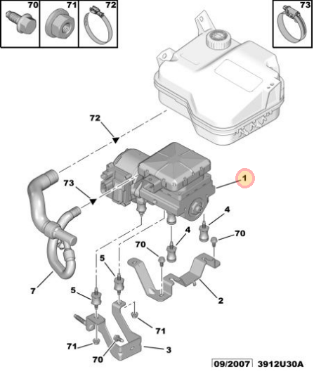

Ok so the OEM Original new Part was 5277K3, but no longer available, nor is the pre-configured BHI Part: 5277K4
Citroen do offer an exchange BHI, Part: 1680917880 (which needs configuring), priced at £962.05, for which there is a surcharge on top of this refundable with the old unit.
A new one was priced at £1434.36 when they were available.
Here's a teardown...
