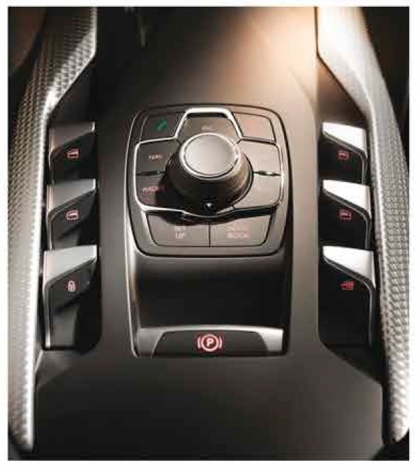

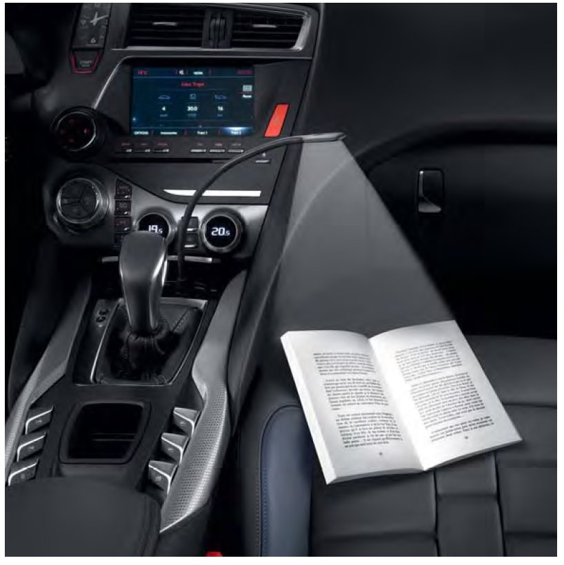

Was RT6 a touchscreen? Citroen DS5's used to have a scroll wheel and buttons by the gear stick, which was omitted from the DS version and replaced with a cupholder (for square cups only!), i.e. the sweety tray I mentioned earlier. This was presumably when it became a touchscreen.

The original Citroen version...
The facelift with the sweety tray...
