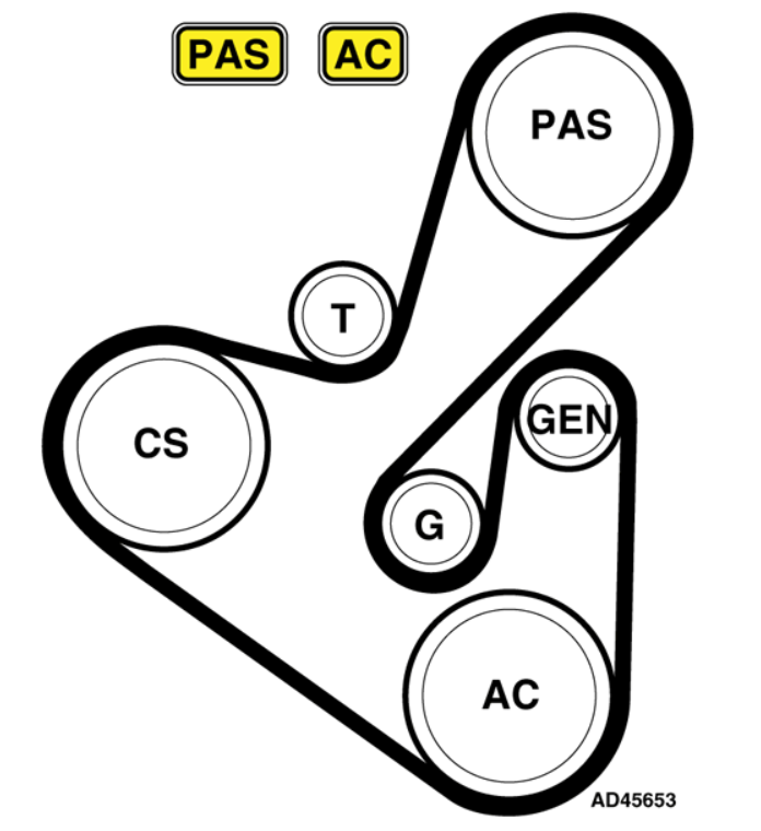

Hi all can anyone confirm this is the correct routing for the aux belt please and also that the tensioner is in the right place?
I bought it recently, tensioner body was worn and belt running wonky, replaced belt and tensioner and there's a keyway in back of tensioner that fits into block.
However there's still a vibration on start up and the tensioner looks like it's moving too much, I'd also say the tensioner looks too close to the pulley, does it look right please?

Looks right, if the tensioner was fitted wrong i would expect the belt would have been either impossible to get on or flapping about.

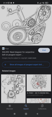

Thanks Wheeler, I fitted it all the same way it came off, drew a diagram etc before replacing, replaced it with an FAI tensioner which normally is a reasonable manufacturer?
Just seems weird how it's tensioned so close to the crank pulley, I'd expected it to look something like this.....
