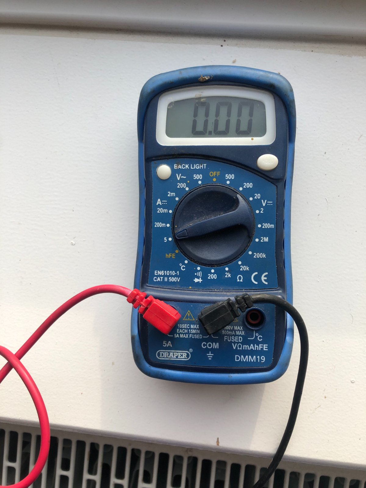

I had the meter set on '5'..
I'll try to send an image of how the meter is set...

Re: Battery drain.
This is how I have the meter set up....
Not sure if its right though.![Image]()

OK, so that is a 0 - 5 Amp scale so you are reading 2.37 amps. That would suggest you have a current draw which may well be the cause of the clicking. The first thing I would do is connect the meter as you did such that you can read it from the fuse box position and then remove fuses one by one checking the reading each time. When the reading drops to under 0.1 on pulling a fuse then that will be the circuit with the fault on it. The next move will depend upon which fuse it is so I suggest you go through that procedure and then post the result. Be sure to only have one fuse out at a time and clean both the fuse and its socket before reinstalling. Good luck!

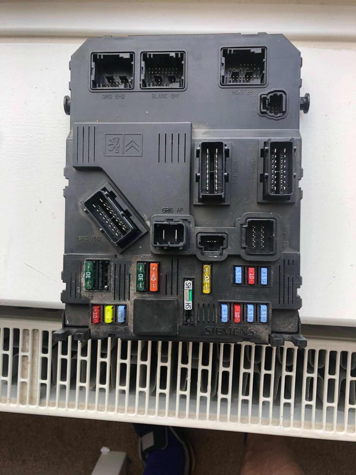

I have another fuse panel board
from the same vehicle from a breakers yard.
I'm probably wrong but i'm assuming something inside the fuse panel in my van is not working properly..ie no voltage at the fuse point?
Is it a matter of just swapping the panel to try it....or will it need 'programming with PP2000 because it's come from a donor vehicle?
Thanks

When you say there is no power across the fuse terminals, there won't be unless the circuit you are testing is switched on so that the earth from the far end of the circuit will give you 12V across the fuse. You should put the red lead on the fuse terminal from the supply and the black lead to a known earth, I always use a door hinge which is easily accessible. On the supply side you should see 12V but on the distribution side you should have nothing with the fuse out and 12V with it in. Likewise when you test the power feed at the light you will need to have one of the switches, door or manual in the on position. You really need the vans wiring diagram to check that out as there are a number of switches in the circuit.
As to the need to reprogram, that is something I can't comment on with any knowledge, maybe someone else will!! Personally I wouldn't think any programming would be necessary but I honestly don't know!!

You cant reprogram the BSI to be used in another vehicle, not with dealer tools anyway.
You could fit it to your car for testing the interior light however you would want to disconnect the instrument panel first as if the test BSI has a higher milage stored in it then it will permanently write the higher miles to your instrument panel.
The vehicle will not start with this BSI fitted but should allow you to test the electrics.
If you want to use the other BSI you would ideally need the matching engine ECU & a working transponder chip as they are all a matched set.
