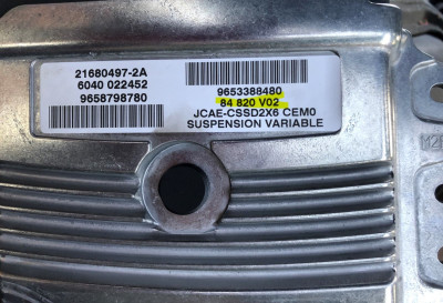

b) there are a few suspension ECU's that have the same part numbers but say V10 and not V2 (which is my unit) - see pic - any issues
c) do I need to reprogram anything to fit a donor V10 suspension ECU ?

Thanks Marc
out of interest, is the V10 the newer version of V2 ?
cheers
cheers

The part numbers are the same, but there are likely differences in software versions and possibly hardware internally.
One thing I do suggest if you are even considering replacing it, is to copy all the configuration of the old one first before removing it, so you can configure the parameters correctly on the replacement.
