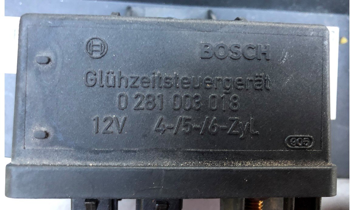

I found the relay 0281003018 under the ECU but can't seem to spot the glow plugs themselves on the engine ?

The relay date is 2006 so assume original.

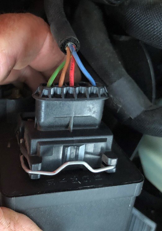

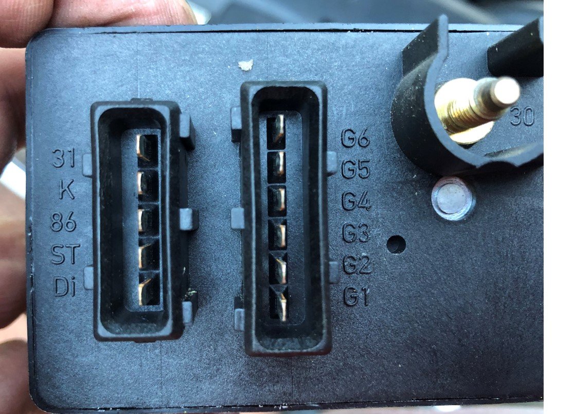

Is there a way to test the relay ? I noticed it has 4 wires into a 5 pin connector (as per pic ST is not connected))

I actually pulled the 6 pin connector off and tested each of the black wires to earth so assume if they were open circuit the glow plugs would be kaput - they all read around 1 ohm so assume they are okay ?
Do you have a circuit diagram for the relay to see what the pins do
ps - it seem numbers like 86, 30 etc seem to be common amongst car relays but not French ones

Re: 407 2.7 Hdi glow plugs and the P1351 pre heating relay
1158: pre-postheating control unit
1376: Pre/post-heat unit command
1386: Pre/post heating diagnostic info
1223 : Engine management main relay power supply
1159: glow plugs supply shunt /
Wiring:
1189 : Pre-heat plug 6 command
1188 : Pre-heat plug 5 command
1187 : Pre-heat plug 4 command
1186 : Pre-heat plug 3 command
1185 : Pre-heat plug 2 command
1184 : Pre-heat plug 1 command
Wiring:
