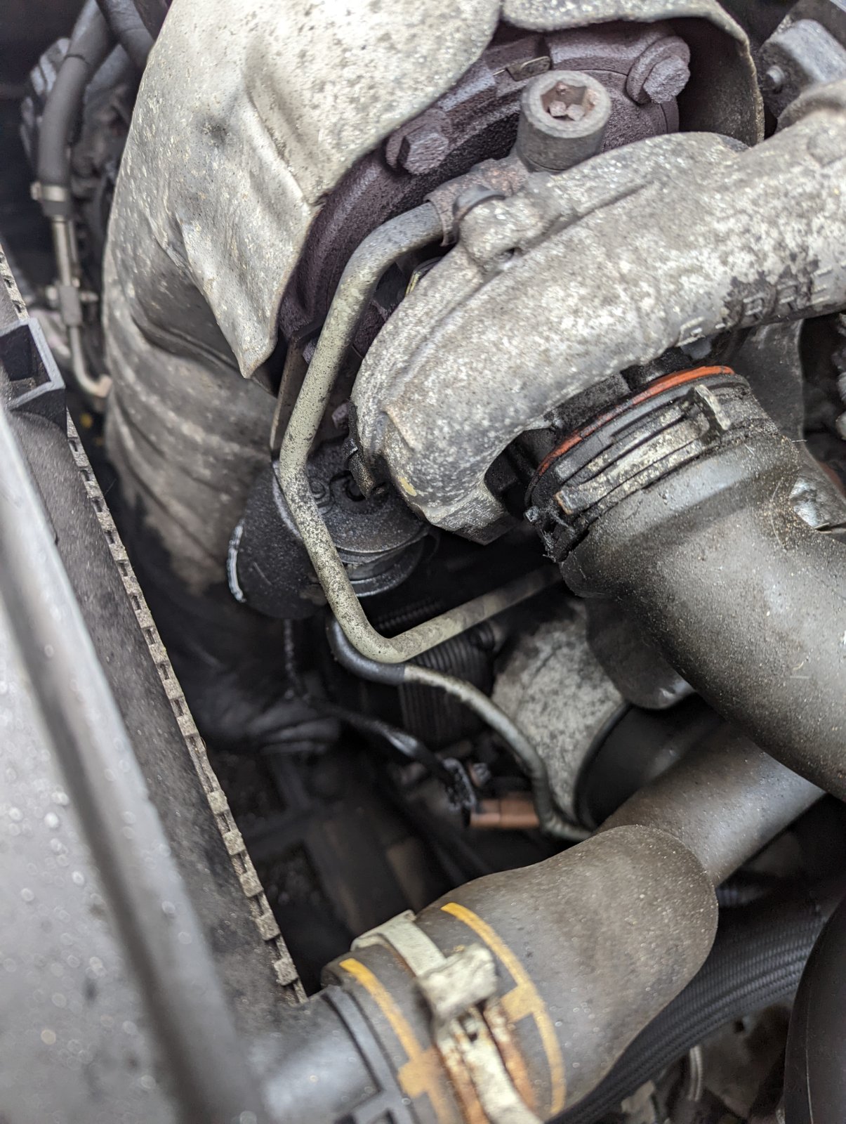

There is oil leaking from one area but ill have to attach a picture of it later when im back at the car. I dont believe its over the gearbox but it could be interfering with other areas.

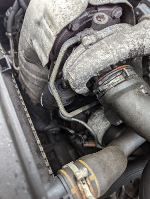

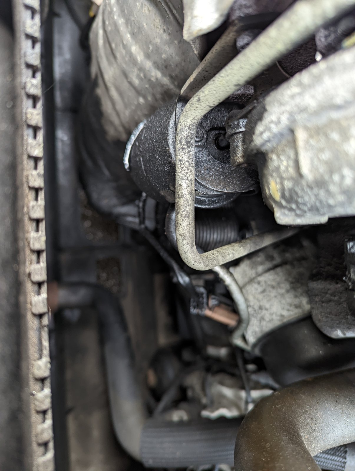

So as I'd mentioned, this is where i see the oil leak coming from. Not sure where its from or what its causing but could be an issue either way

That's the turbo - if you look to the right of there past the radiator top hose you will see the actuator on the front of the gearbox.

That might explain the slow uptake feeling like its in limp mode.
