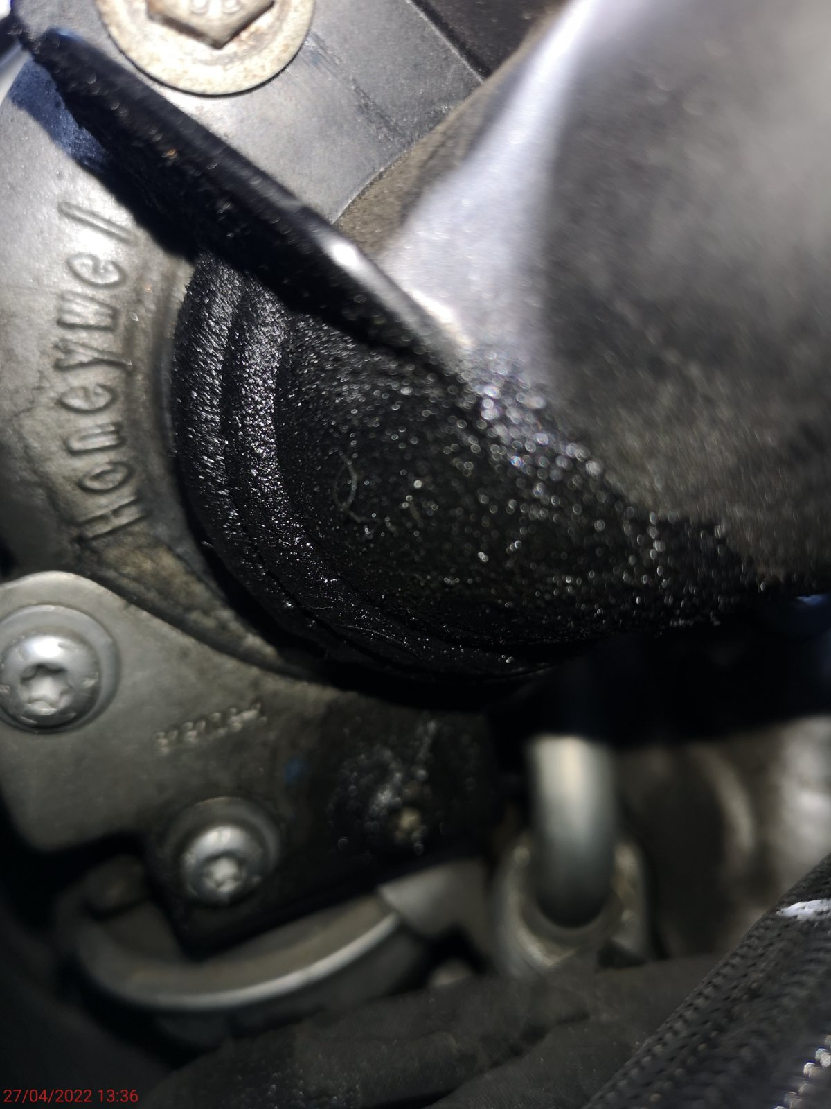

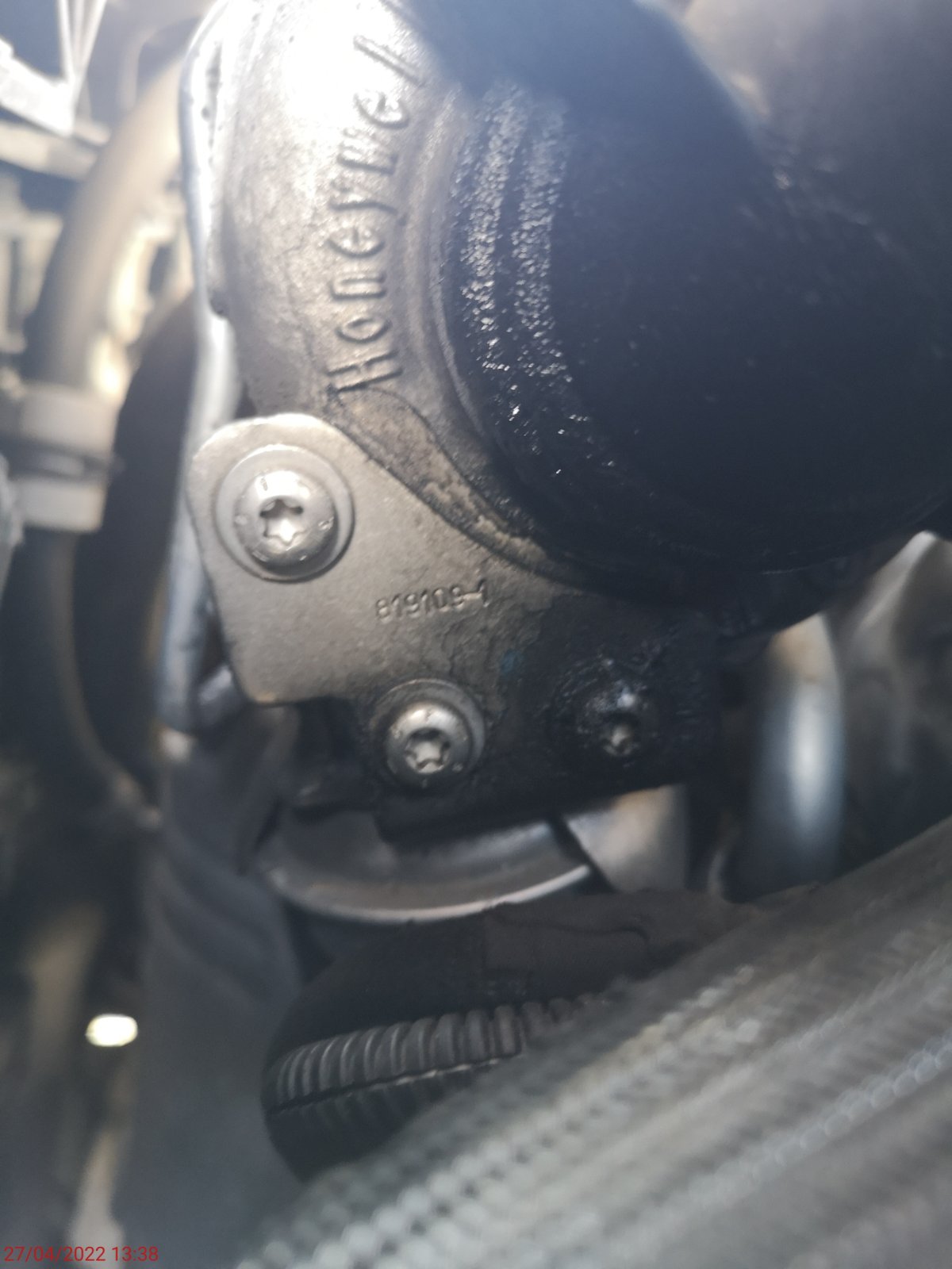

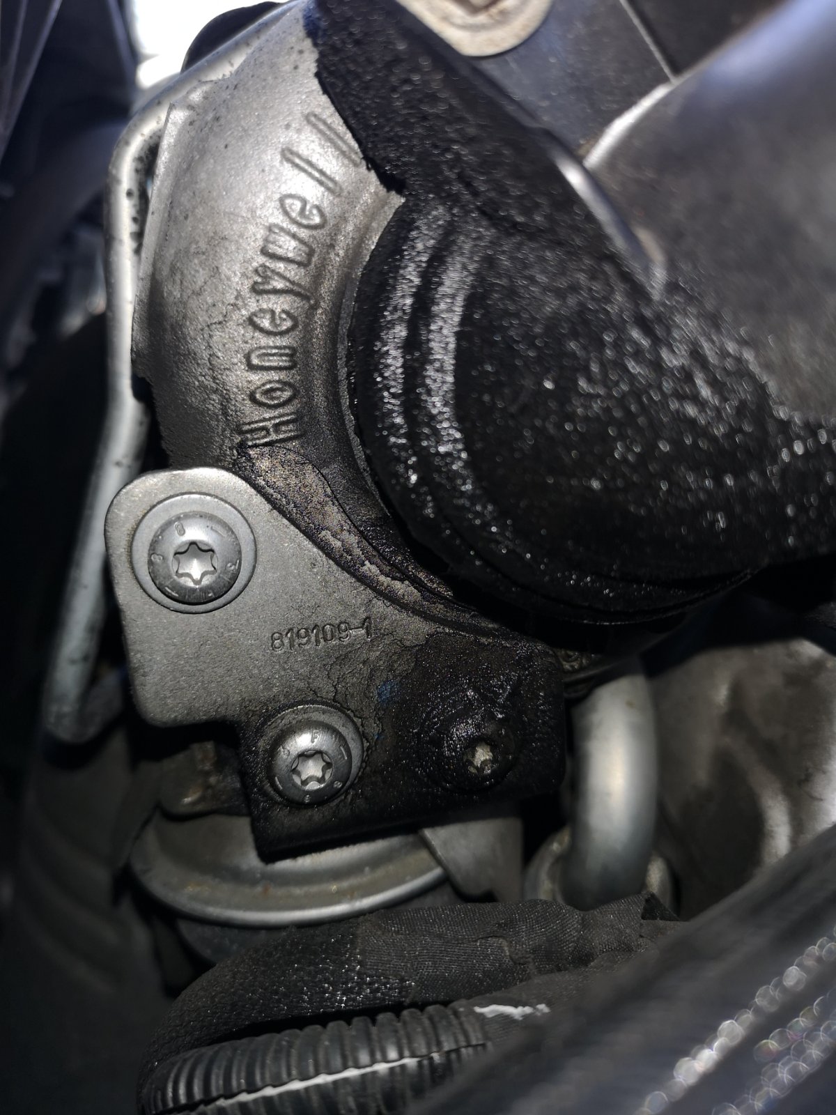

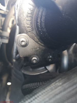

Is this oil leaking from the turbo? Is it serious? Would an extended warranty cover this repair?

That will almost certainly be oil from the crankcase breather system, it returns from the rocker cover to be passed through the turbo and burned, it is normal as long as the pipework is not blocked up with gunge. neglecting oil changes can cause this, as can short journeys.

I've just had exact same issue on my B78 (65 plate).
However, both pipes coming into the turbo were clear. upon stripping the area down, it looks like splater of oil (as in pic above) was coming past the final o-ring of the pipe that attaches to the turbo inlet.
The o-ring in question is a normal nitrile 60mmOD 51mmID with a width of 4.6mm. STD o-rings are 60 x 50 x 5. So ive swappen mine out and hey presto. leaks gone, but nasty stain remain.

That is normal, as long as it is not driplets on the hose.
