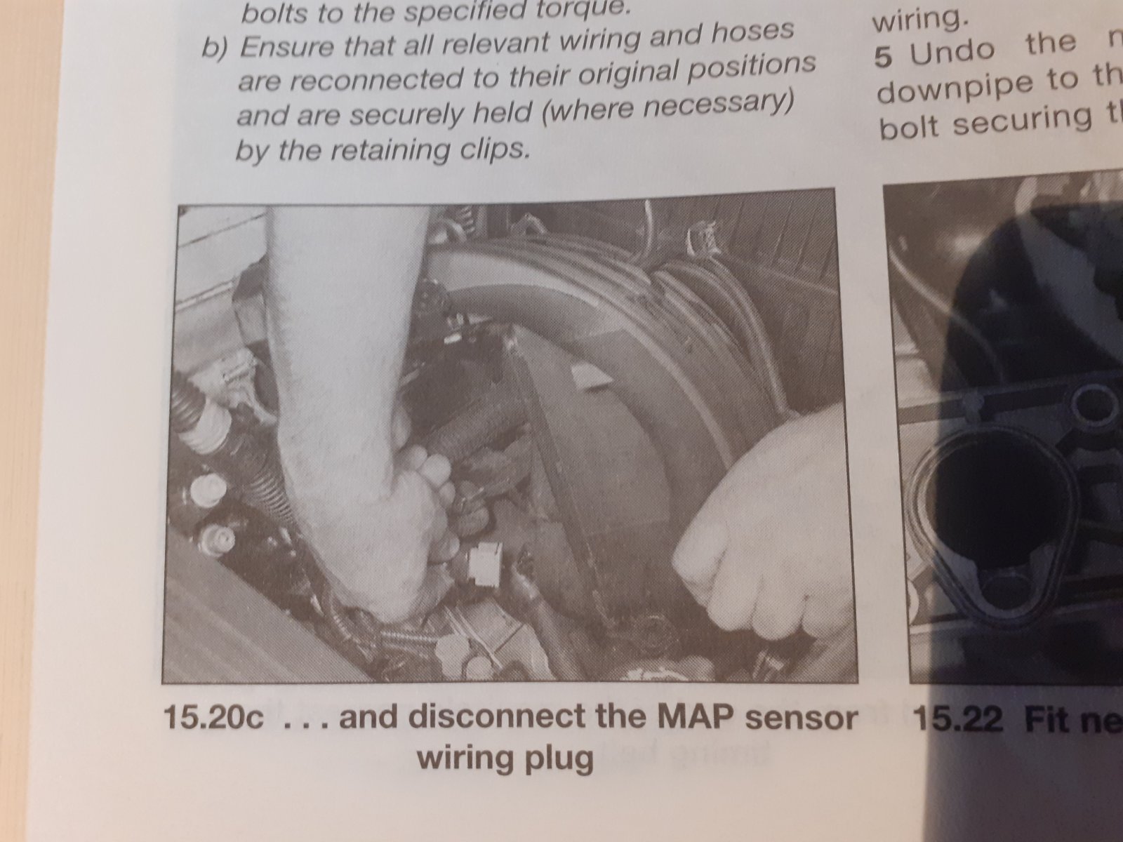

So a couple of days ago I replaced the throttle position sensor. The car has definitely improved, when I release the gaspedal it's not shocking anymore. But it still hasn't completely resolved the idle issue. I guess the leaves the MAP sensor but I can't find it, does anyone know where it's located?

It's hiding behind the inlet manifold, if I remember rightly on my uk spec car I had to take the air filter box of to get accesshttps://frenchcarforum.co.uk/forum/download/file.php?mode=view&id=42049

I might add that the MAP sensor is mounted to the left side of the firewall with an bracket and has a vacuum hose running to it, at least on my 1996 2.0i 8v RFX Xantia. On the 16v cars it is under the manifold I believe.

i5xp is right, that photo is for the later 16 valve models.
According to Haynes it's on the underside of a mounting bracket, left side looking from the front, about level with the strut top.
