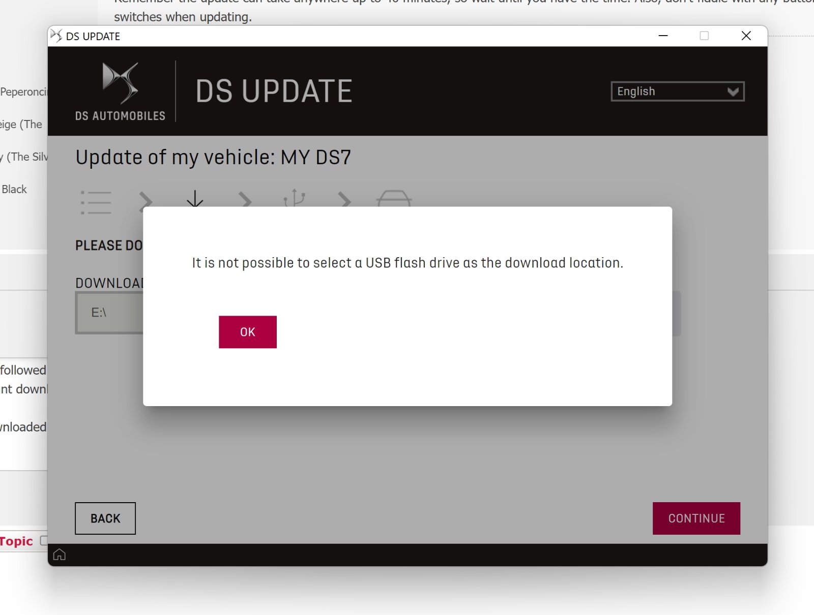

Re: DS7 Software Update (19 reg)
Marc,
i get to your step 4 where you select the destination for the file download. That is where it fails as it wont let me download the update file to the USB flash drive with the message
"It is not possible to select a USB flash drive as the download location"
If I try to down load to a folder on the PC (with a view to copying it on to the flash drive later) I get the message
"disk space is insufficient"
After reading your last message I will find a 64GB flash drive and try again!
Thanks
Ian

- x 6957
As Paul mentioned this is a 2 step process. You must first download the utility programme to your PC.Iansel wrote: 20 Apr 2022, 08:58 Marc,
Thanks
Ian
This may get downloaded to your default downloads folder unless you specified somewhere else. Note the name of the executable file.
Next locate the downloaded file above and install it on your PC.
When the programme is installed, you open the programme, then use your VIN to search for the system firmware update and map updates that are available. The utility will guide you on the rest of the preparation of the USB.

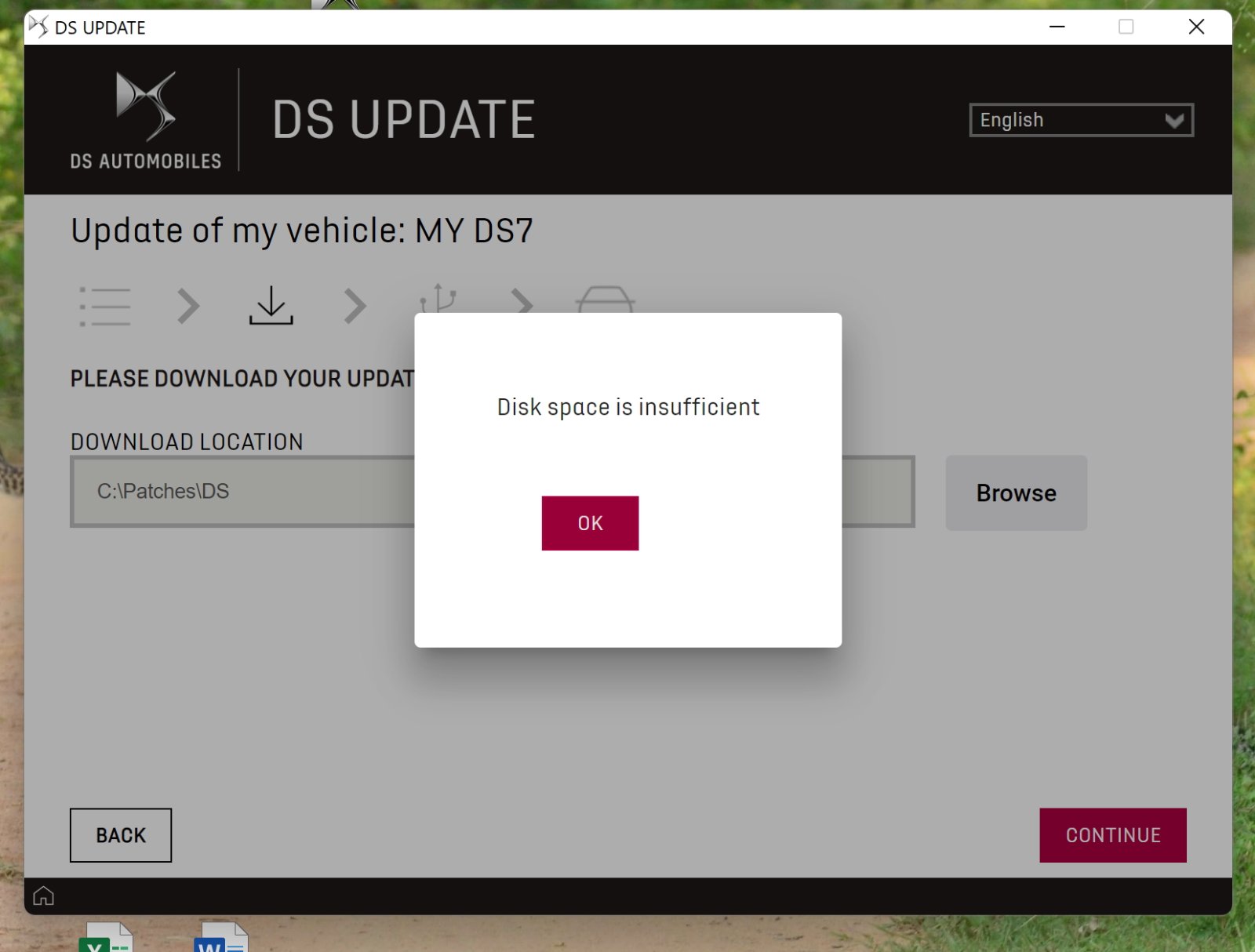

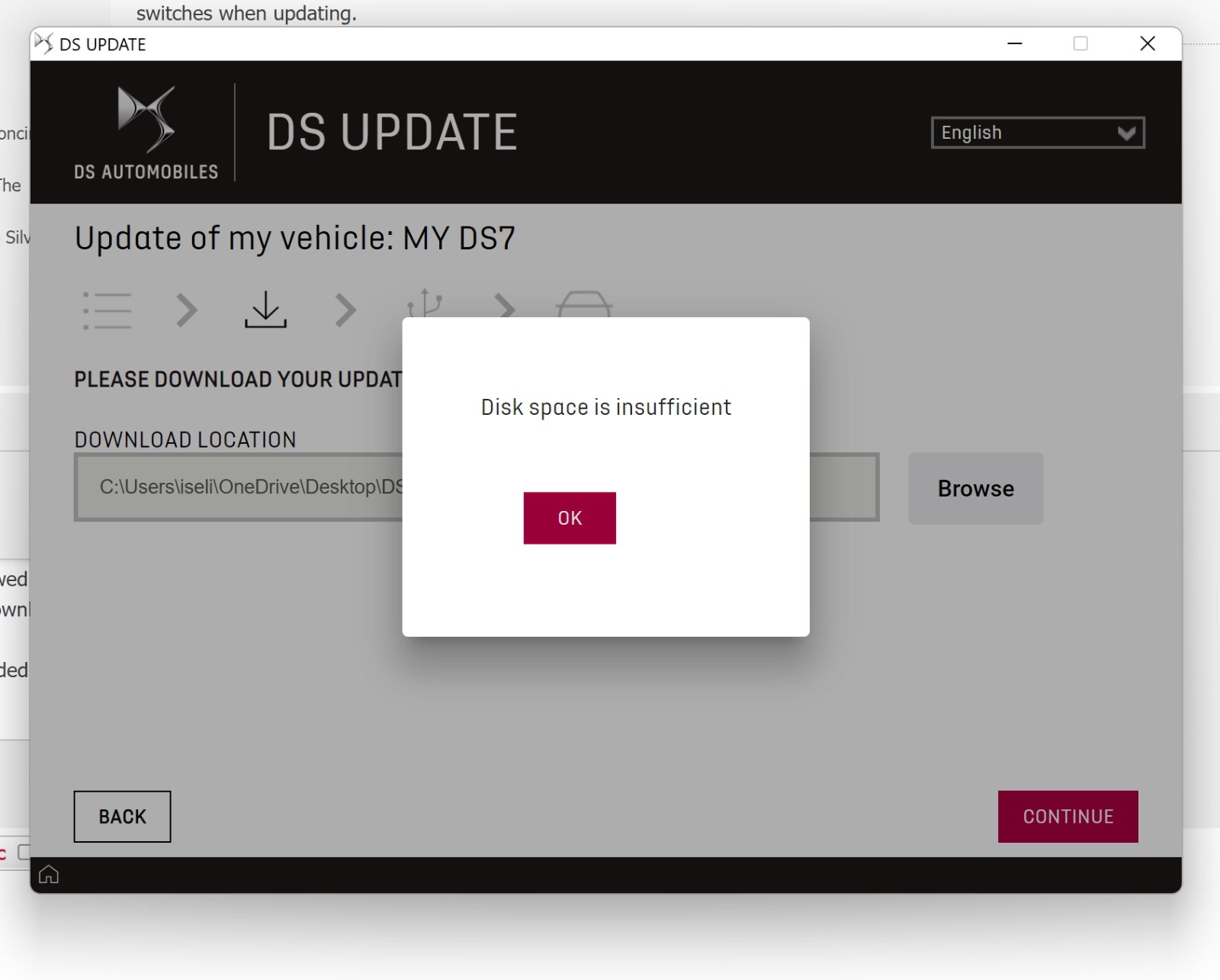

I have downloaded the installer and installed the app on my PC and it runs. I have entered the VIN and it has returned that an update is available.
The problem only occurs when I try to download the update file to either my flash drive or my hard disk. That is when i get the two messages.
I will get a bigger flash drive and see if that makes any difference.
Ian

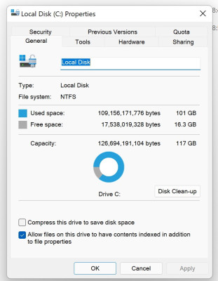

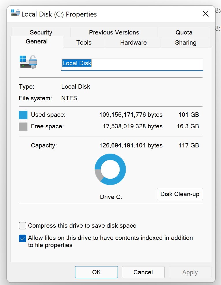

Looks like you're trying to save into your OneDrive which is virtual. Save it onto the computer's hard drive.
OnlineHell Razor5543
Sometimes having too long a location 'string' can cause issues. Might I suggest that you create the following, and see if the files will be downloaded to it?
C:\PATCHES\DS\
EDIT; I didn't spot the OneDrive bit.
C:\PATCHES\DS\
Hell Razor - Well I have tried that with no success. Surely the download cant be more than 16 GB!
Has anyone successfully downloaded the update and can tell me how big it is?
- x 6957
Yes they can Ian, so if your PC Hard Drive is short on space it won't allow the download, as it would leave your PC with virtually no space to run anything.GiveMeABreak wrote: 19 Apr 2022, 18:05What you have to do is make sure you have a USB key that has plenty of capacity, as for example the latest European map update is 19 Gigabytes for a Wave 4 system!
Probably time for a hard drive upgrade.
