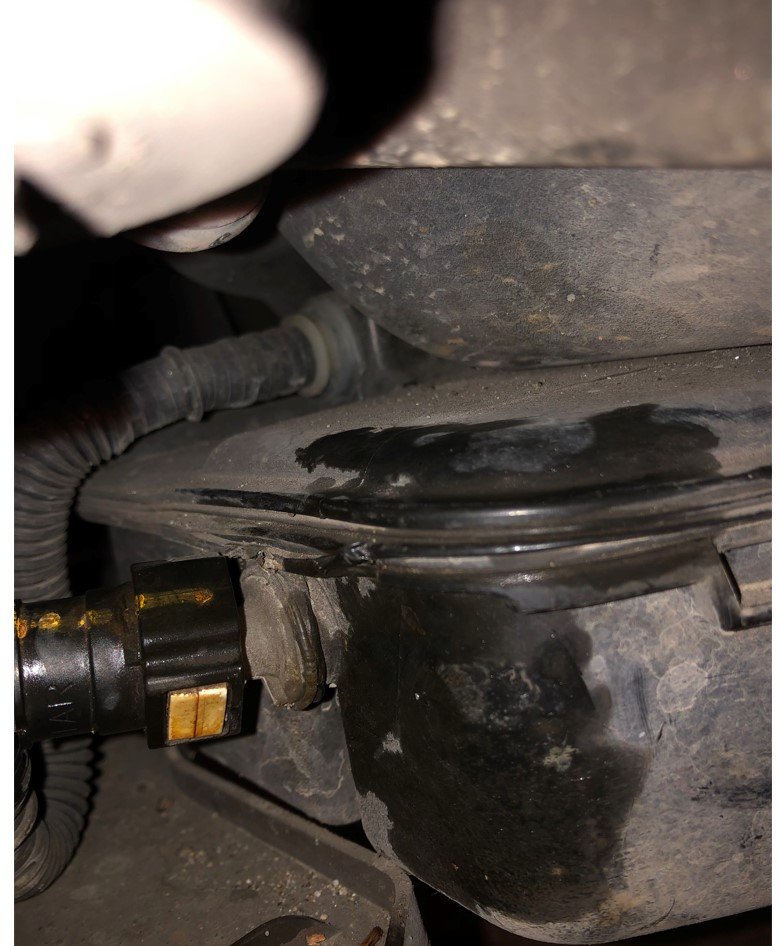

I finally got under the car to check where the DPF fluid tank was
I assume this means I have a white union plus and so need DPX42 ? (Vin supplied before)

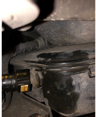

Thanks Marc
Is this plug in the pic the correct union plug (and refill port) ? Looks white to me (or maybe a faded yellow)
According to the Walkers chart etc its supposed to be green ?
cheers
cheers

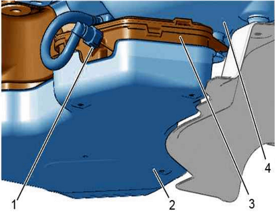

The colours of the click fit unions change - that's why it's important to go on the build date. In your vehicle's case it can be green or white.
(1) Additive reservoir filler pipe.
(2) Additive reservoir heat shield.
(3) Additive reservoir.
(4) Fuel tank.
(4) Fuel tank.

Eolys 176 fittings can be Green or White but as said this is only a guide & the only way to confirm is by build date.407 wrote: 13 Dec 2021, 19:29 Thanks Marc
cheers

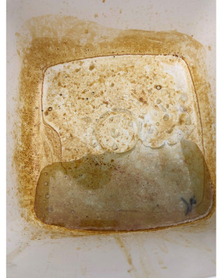

On the basis that its done 145K Kms, I assumed the DPF tank might be empty so unbolted the cover, fitted the Eolys refill bottle and hose and found that it was full (eg would not take any liquid out of the bottle and started to fill up the filler tube)
Pic of what come out, which went yellow in my white container so assume urea.

Well the first thing I can tell you from that picture is that it is not Eolys. Eolys is generally a blackish-brown colour and never clear.
UREA is only for later vehicles with a Selective Catalytic Reduction system fitted (SCR) and that has a separate UREA tank and this system was not fitted onto PSA vehicles until about 7-8 years later than your vehicle (usually but not always having the Blue HDi in the name).
1) So if this clear liquid is what has come out, you need to completely remove and drain the tank to get rid of whatever this liquid is and hope it has not damaged the pump.
2) If the tank is full of whatever gubbins is in there, then it has not (thankfully been injecting it in to you fuel tank.

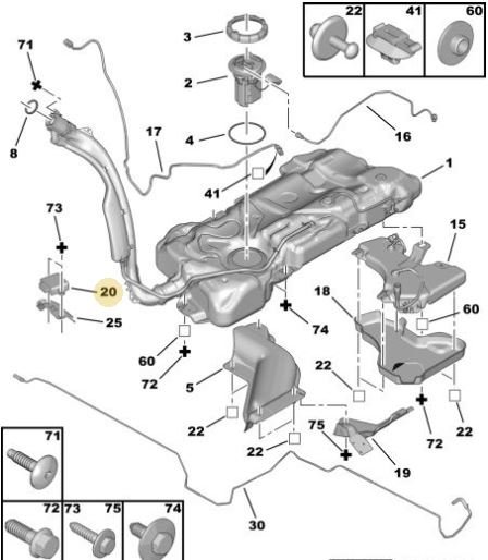

3) The DPF system on your vehicle is showing up as having a separate additive ECU. On later vehicles the engine ECU controls the multiplexed additive pump and therefore the dosing. On earlier systems, such as yours, there is a separate ECU to do the job, however it is well known that these boxes often failed and could not be reset which is required after the additive system has been topped up. The additive tank is not physically measured for additive quantity. It is estimated from the amount added at the factory and if it has subsequently been topped up, which is where the resetting of the additive ECU comes in.
4) If the additive ECU has packed up it won't command the pump to operate (and thankfully in your case as you don't want whatever that liquid is getting into the fuel system.

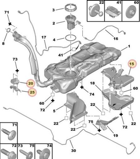

So several things to do. In either case, the additive tank needs removing and emptying and cleaning and hope the pump is not goosed. Then the additive ECU needs checking for operation (but not while the Eolys tank is full of that clear liquid). If as you say the global test is not communicating with the additive ECU, then it is likely goosed and probably needs replacing.
The additive tank is (15)
The additive pump is built into the additive tank and metered doses enter the fuel tank via the pipe (16).
The additive ECU is shown as item (20).

Can I get some parts number for 73 (20 and 25)
Can you buy the dosing pump separately or only as part of 15 ?

Ok,
The additive reservoir contains the pump (15) but is no longer available from Peugeot, but the part number was: 1500Z9 and was priced when available at £452.27
The additive ECU (20) is part: 1525CY, £208.61
The ECU harness / bracket (25) is part 153945, £6.46
