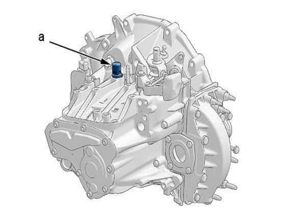

The oil quantity after draining can be different on the 6 speed ML6 box depending on the version. The ML6C box can be made with or without fins and this affects the capacity:
ML6C Gearbox
Gearbox casing with fins 1.9 litres
Gearbox casing without fins 2.6 litres
It has to be gravity filled using the vent hole at 'a' as these are 'filled for life', so there is no general filler port.
ESSO 75W80 EZL 848 or TOTAL 75W80 H6965
No you don't need a diagnostic tool to change the manual gearbox oil. You will need to replace the drain cap with a new seal though.
ML6C Gearbox
