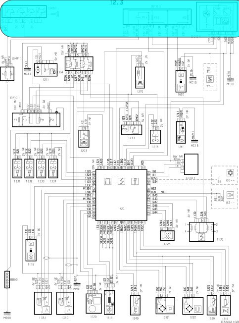

Difficult to tell without the diagram, but pins 7 and 50 that go down to 1V with the key on look suspect...

Re: Xantia Immobilser Problem
Sorry I have the diagram in svg format but the attachment failed
Have converted to jpg format (with some loss of quality)
Hope the attachment works this time!
