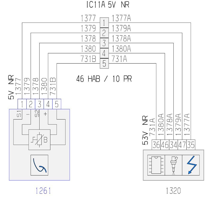

Here's the wiring and Pin outs for the accelerator (1261):
1377: Accelerator pedal 1 position info
1379: accelerator pedal position earth
1378: Accelerator pedal 2 position info
1380: + 5 volt accelerator pedal position indicator power supply
731B: accelerator pedal point of resistance / signal

Re: Throttle pedal position sensor
Thanks again for this. I studied it last night, printed it off and made myself an order of tests to do.
So this morning I went out, identified the ECU, the correct plug, unplugged it and found the bottom wet with blue water. Can't figure out the blue, the only thing blue is the window washers. I did have a blown expansion tank pipe a couple of months ago but the anti-freeze is pink. Anyway, I took the ECU off the car, onto a bench dried it with cotton buds, then alcohol, then the wife's hair drier, lightly scrapped the blade connectors with a fine screw driver, repeated, then did the same with the plugs. None of the male connectors were heavily marked/corroded, although harder to say about the plug end. Re installed and got the same P2122 & P2123 errors but all other errors disappeared (positive result). The car is in limp home mode, the butterfly valve is cracked open and returns to closed when ignition is off.
So, I'll be doing the checks re pedal later today/tomorrow. Question is how do you access the terminals on the plugs? I'm guessing the latch mechanism comes off; the cable anchor is a cable tie and there seems to be press in tangs to release the terminal block? Is there anything else to releasing the terminal block? Don't want to find I do something irreversible at this stage.
