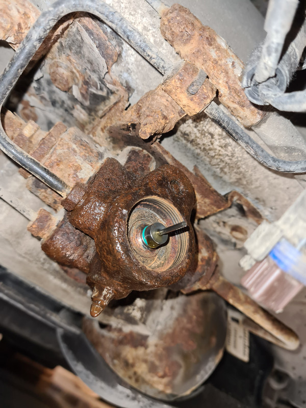

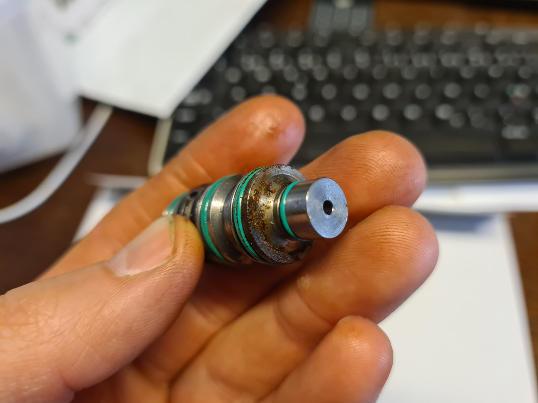

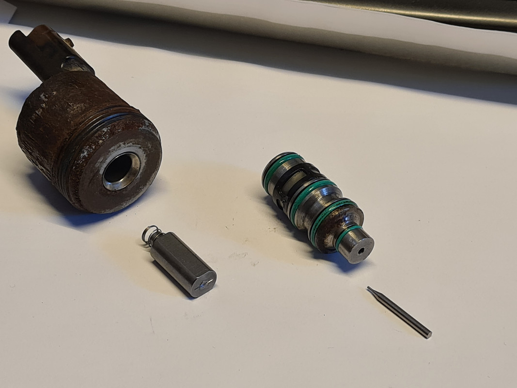

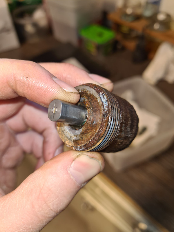

I managed to remove the solenoid and I think I found what is making my rear suspension act up. The slide is not moving freely all the time. If I twist the slide while it's in the solenoid, it can get a little bit stuck.
Going to give it a rub with some fine grit sandpaper and see if it frees up. Does anyone know if it's possible to buy only the solenoid with slide as part?
I also removed the spool and noticed a bit of rust. Adding some pics for documentation.

The dreaded rust!
Just make sure you have it independently supported whilst working on sensors or the hydraulics as the car can crash down without warning whether powered or not.
The blocks have been a source of problem for both X7 and C6 owners with erratic suspension, so hopefully you can fix it with a good clean up - Citroen of course do not supply any internal parts for the hydraulic blocks or the BHI unfortuntaley.

Success! I can report that the rear suspension is now moving smooth up and down. Remains to be seen if it holds up, but I have a good feeling.
