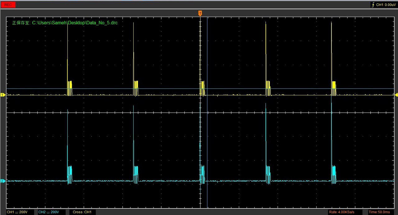

The operation of the injector was compared and check between the injection timing .
With oscilloscope and the following was found This doesn't make sense to me
Injectors 1 and 4 open at the same time, there is no time difference.

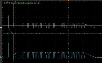

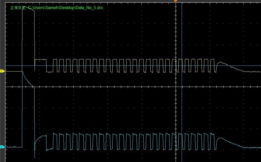

Injectors 2 and 3 also are opened at the same time, there is no time difference.
Can anyone help me with this?
