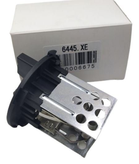

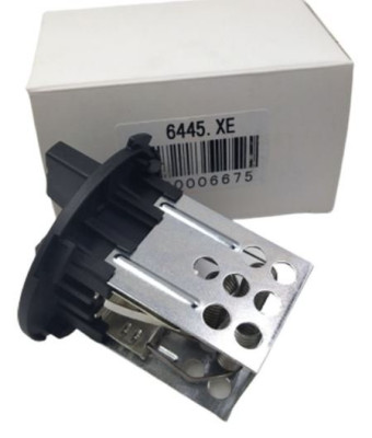

My first thoughts are the blower motor control module. These modules control the fan speed. When they fail, it can mean the fan is not working or the fan is constantly on full speed.
The fans usually spin up slowly to the required speed. If the blower motor has condensation or moisture on the bearings which can seize them, it can prevent the motor from getting going due to the initial lower power used to start the motor.

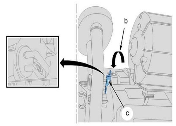

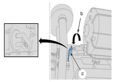

Ok, so on your C4 you have single Air Conditioning, so the blower control module is different.
You need to remove the front left side passenger footwell trim near the gearbox binnacle to get access to the centre console space. You may need to remove the trim under the glovebox if necessary.
This is the module you are looking for:
It's located just next to the blower motor to the side of the heater matrix pipes as shown. You need to disconnect the connector and turn it counter-clockwise to remove it.
