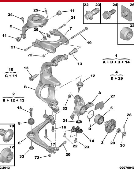

Sorry to sound like a complete moron, but just want this sorted as I love my C5 and want her to go on a rubber-free diet - any advice and help from you guys (including suspension diagrams, parts lists, etc etc etc) would be hugely appreciated.

Most likley you have a trackrod end loose. Have you checked for that?
There are a few bushes in this front end otherwise. No 12 and 14 are most prone to wear. The bush at "32" in the upright also can fail.

The ones on mine that were completely shot were the bushing where bolt 20 goes through the bottom of the upright although strangely not numbered here? To the left of the number 32.
These need to be pressed out and the new ones pressed in very straight. But it can be done. There's a good YouTube video by 'madforfrenchcars' where he does this on a Peugeot 407 that has the same assembly.
If it's the outer track rod ends these are easy to disconnect although the rod end nut can be super resistant to moving. Only special tool would be a balljoint separator. Also wire brush the adjuster part of the track rod and take a photo of the number of threads on each side so as to get the new track rod ends in the right place. Both sides should have the same number of threads showing. I'm sure the number on mine was around 8 full threads a side as a guide. Then if your steering wheel is a little off driving straight, you can adjust a quarter turn one side or the other. You'd still have to have the tracking checked though by a garage.

Ha sorry, didn't spot that you'd mentioned bush 32 there.citroenguy wrote: 20 Mar 2022, 19:06 Most likley you have a trackrod end loose. Have you checked for that?
