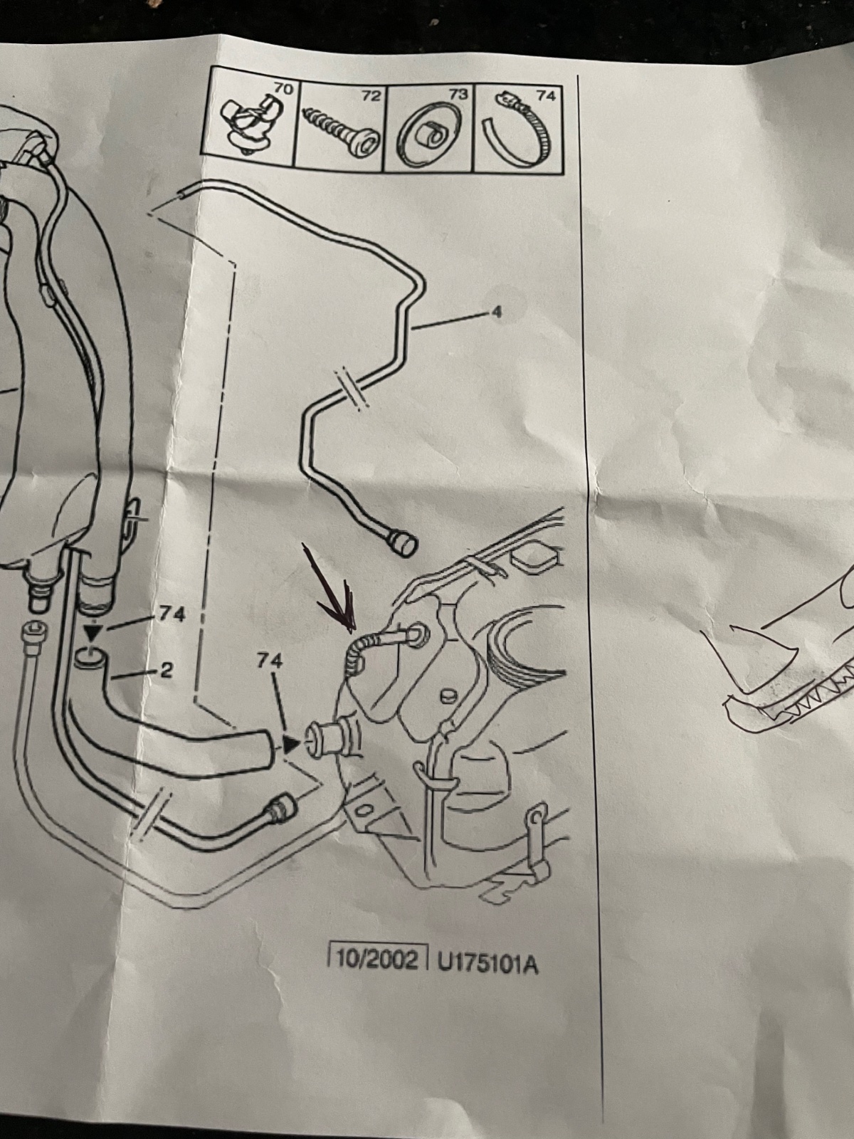

Good morning all,
Could someone please help with this part please.
My garage said that the main dealer told them that
this part is discontinued. They gave me this picture and told me to try buy this hose ? my self but did not tell me how is it called. If anyone knows how is it called and where to buy it I will really appreciate it.
Thank you very much

The item the arrow points to does not have a ref` number? so it must be part of the tank. OR? is it item 4 the part you want.?
What ever, First try Dean Hunter at www.peugeotparts.co.uk he may have something that will do the job. Failing that I`m sure a clever mechanic would be able to make something up

The item arrowed is part of the complete fuel tank assembly and the tank is no longer available.

As I said, it’s time a clever mechanic to make something up.
Locating and fitting a second hand tank would probably create more problems, plus it’s a horrible job.
