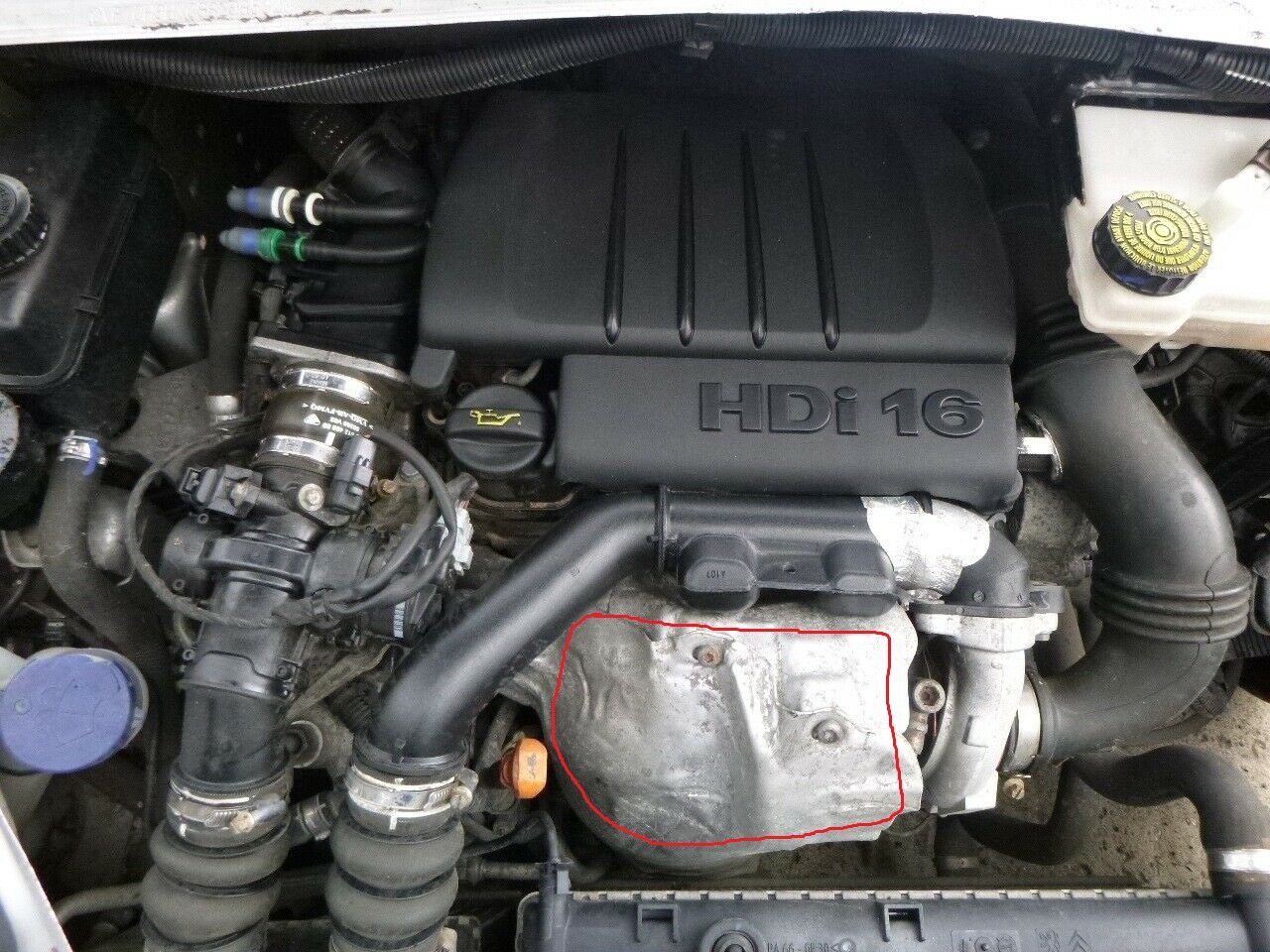

Also, if anyone can assist, I'm looking for the aluminium cover that attaches to the block just behind the turbo and goes down to near the bottom of the engine, no idea what it's called. It rattles despite tightening up a few of the screws(2 of which are too small for the enlarged, worn, screwholes)

Edit: Cover is marked in pic.

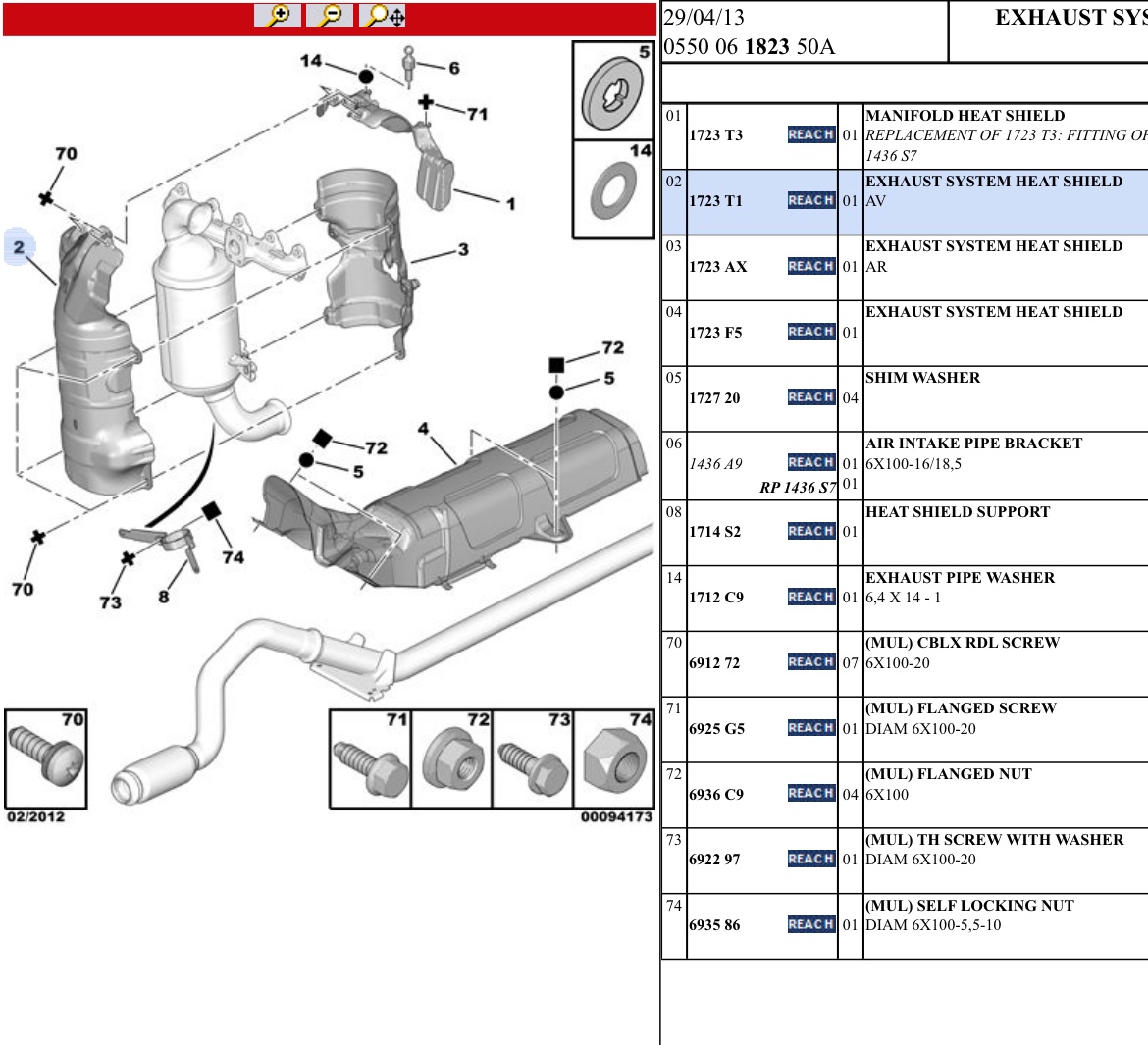

Is it this bit? 1723T1
£61 inc VAT from dealer.
x 6956
Re: Fuse help please
£58.58 inc. VAT from this morning, but may be a dealer variation...

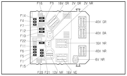

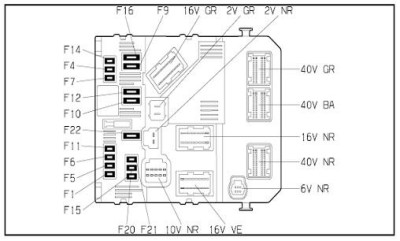

As for the fuse: F22 30 Amp located in the BSI Fuse:

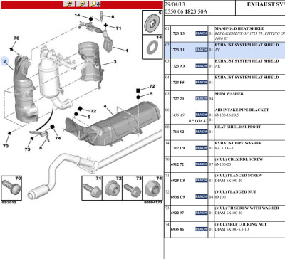

Here you go, you'll have to click the image to see it though :)

They are different part numbers thats why the difference in price :lol:
1723T1 is the front part of the shield.
1723T3 is the top/rear part.
x 6956
Oh, well spotted, I missed that!
From the photo, it looks like item (1) which I nearly put up, but you had already posted. I looked at the other part, but it seemed too big. If you look at the photo, it seems the smaller part (item1) screws into the larger part giving the illusion of it being one piece.
