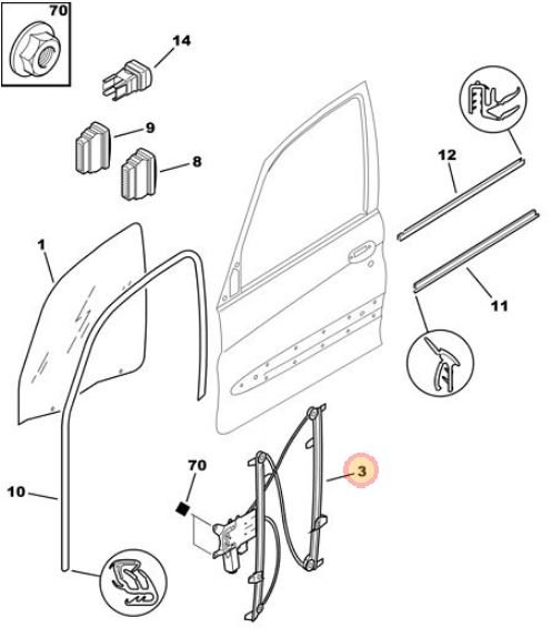

Re: Window regulator help please(Xsara Picasso)
If you need item (3) below, it it part: 9222G0 for the right side window and part: 9221G1 for the left window. They are £401.26 each inc. VAT from Citroen. These are the correct part numbers from your VIN, so get these or the equivalent.
I assume comfort means the one touch function?
If there is nothing wrong with the motor & its just the regulator you should be able to get an aftermarket regulator for around a tenth of that price.
Yes, I forgot to mention that price includes the motor assembly too Tam.
Yes guys, its just the regulator I need but just wanted to know what "Comfort" meant and, Marc giving me the part number helped me source the correct after market regulator for 32 quid.
Thanks again guys.
Oh, Comfort is "One touch" as I found out. Driver window on mine is comfort, passenger is non comfort. Apparently it matters when ordering the regulator.
