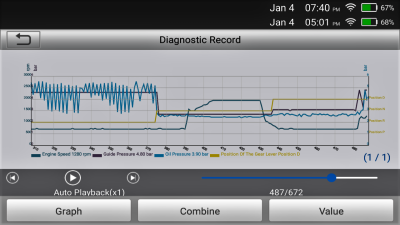

I have carried out some transmission monitoring with a generic scan tool and the oil pressure generally seems to follow the guide pressure with some exceptions when the gears are changing. The display is very limited and it is not possible to download the results so that I can examine them closely. And I think it is recording at 1 sec intervals, so there will be limited data during gearshifts.
