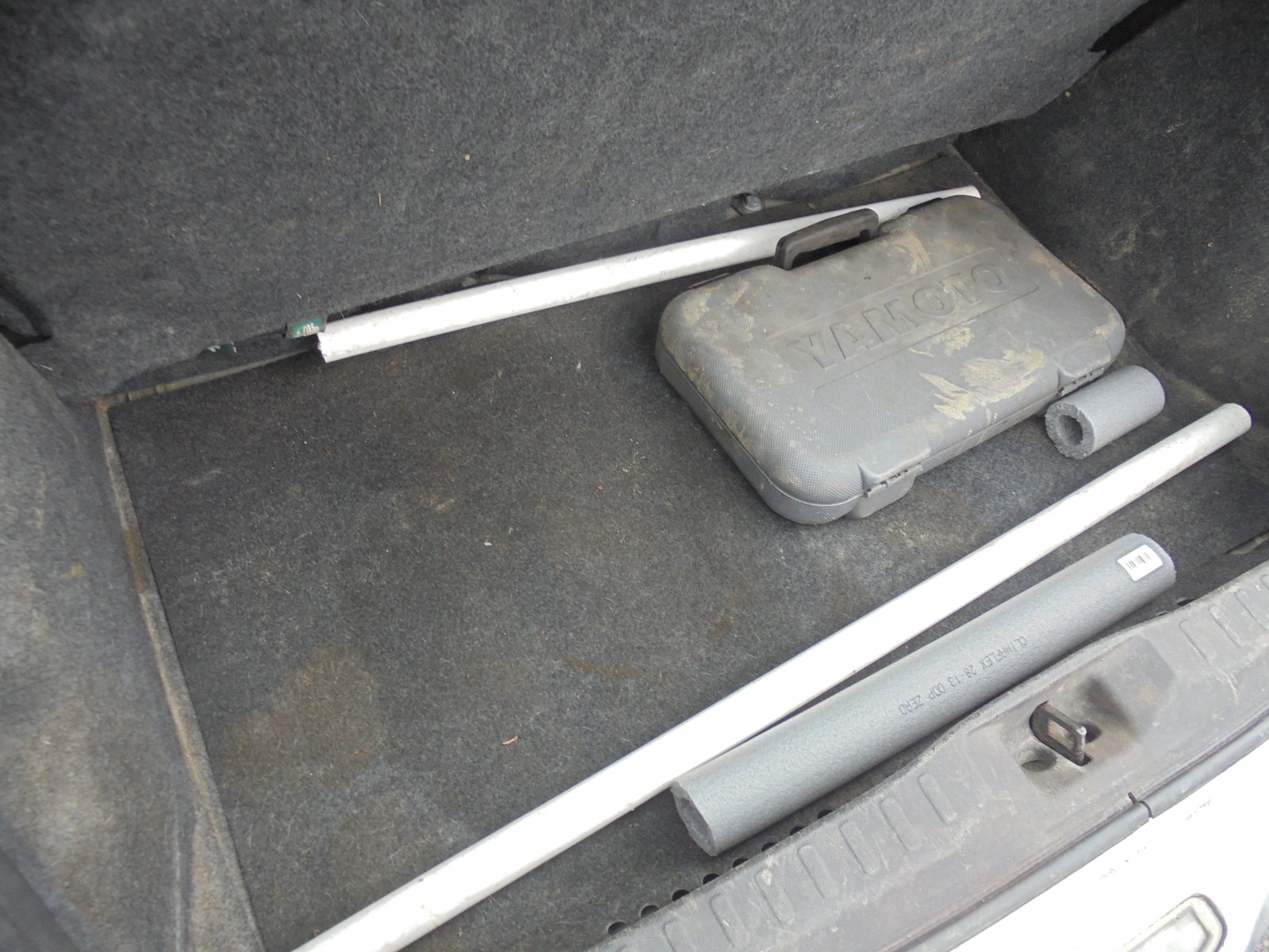

NewcastleFalcon wrote: 17 Feb 2022, 23:06 Remade the joint between the back box and middle pipe which was leaking using this stuff today, decent enough break in the weather sunny, and Dudley had blown over mostly during the night...

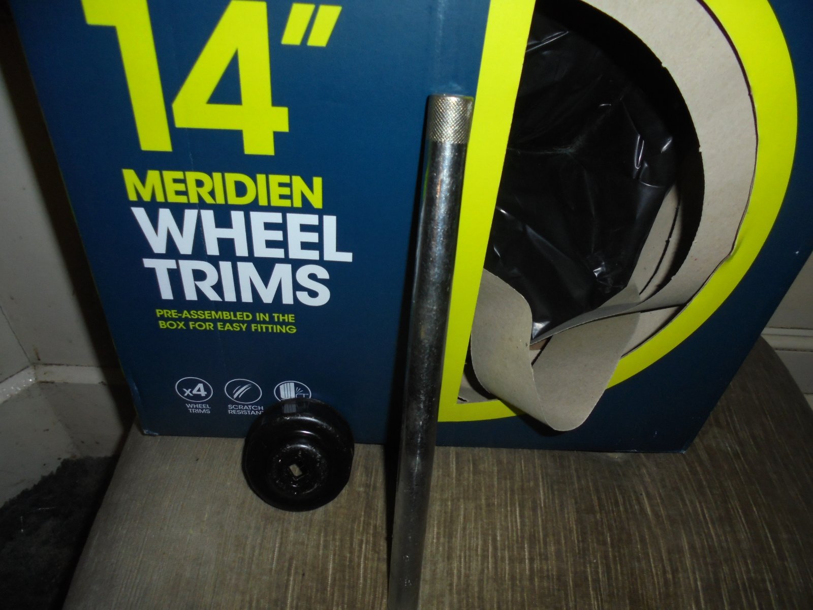

I think I've done all I intend to do. I found I had a new set of spark plugs lying around and although I've done the job, before on a Clio, i decided not to bother. They are buried down some very large holes and require this tool (the long metal tube), to remove them, and then there's stuff to disconnect/remove to get at them, so rather than disturb things I didn't bother. I will have some feeler gauges somewhere but haven't seen them for years, gap supposed to be 0.9 mm.
The other thing in the pic is a good little tool for removing the oil filter, because its in the most awkward of locations matches the flutes at the end of a proper spec Clio 2 Oil filter.

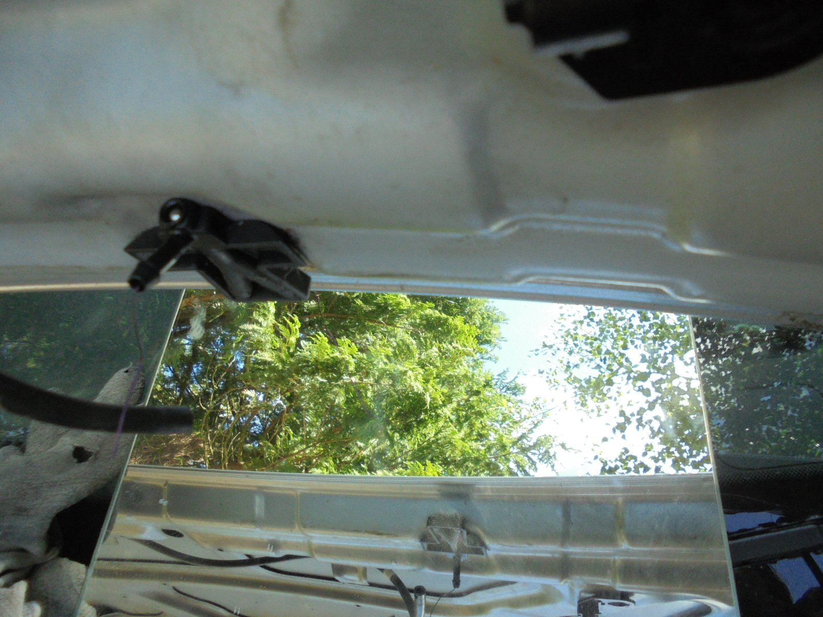

Still weighing up whether to MOT the BB Micra this month seeing as I've done 15 miles and 6 miles in the last 2 months in it. £40 to see whats up with it before I start, probably have to address some of last year's advisories at least involving maybe new tyres, flex brake hoses at the front where the ferrules got mentioned even if there's nothing else.
Did the easy checks lights, horn, wipers, but had to do a bit of a poking a wire through to get the washer jets squirting as they should. The plastic jet fittings are a bit of a cross your fingers and hope they dont break removal job so did the wire poking in situ.
