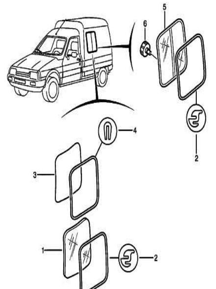

These are the available options:
(5) Sliding Side Window (6) is the Tightening Knob
(3) Is the Side Glass Blanking Panel (4) Is the Lining Piping
(1) Is the fixed Window (2) is the Weather strip
There are no instructions on removing / refitting these but I suspect these are bonded on.

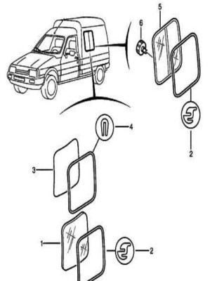

Re: Fitting side windows to a Citroën C15
Just noticed this, and my daily transport is a c15. I'm pretty certain the van metal panel is bonded into place. When they're removed the aperture is correct for the windows as long as you have the correct seals. Go easy on removing the panels as the metal is very thin and easy to distort. Probably best to warm them with a heat gun first.
I had a couple of C15’s, loved them and are currently looking for another, anyway I fitted the side windows to both of them, the metal panels are simply bonded in. Carefully cut away the mastic whilst applying pressure from the inside to pop out the metal panel and clean up the aperture, the windows are simply held in by the rubbers which are installed the traditional way of using rope/string in the rubber to pull the window into place from the inside as you’d do with a windscreen.
