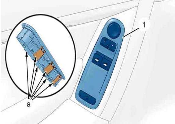

First thing is to check the Driver's side module in the door that controls the passenger window and mirror. This should lever up if you carefully use some trim removal tools as shown below:
When you have removed it, you should be able to carefully remove the case to see inside. Water can get in over time and cause corrosion to the circuit board. Use some electrical contact cleaner to clear up any corrosion.

The contact pads in the control unit can be dirty or corroded.
Clean with Isopropanol or an electrical contact cleaner such as Servisol.
NOT WD40.
Sometimes they can be cleaned with a pencil eraser.

It all makes sense. I opened the door panel and opened the module you mentioned earlier. There was some kind of sticky material of the contacts that control the mirrors, I cleaned everything but still nothing unfortunately
