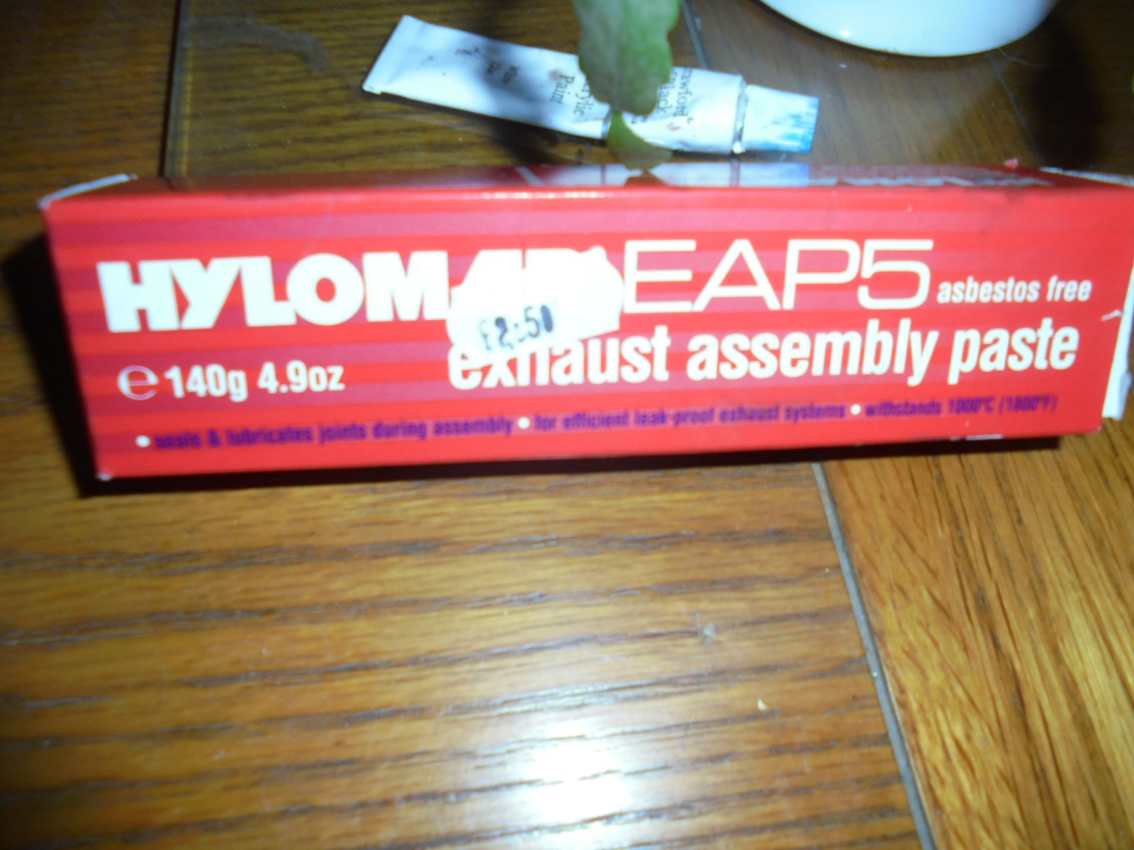

Jobs done, only really the exhaust to redo the back box to middle pipe joint which is noticeably leaking but I have bought some jointing paste so it will get shoved in for a retest with just that sealed up and hopefully will pass.

Remade the joint between the back box and middle pipe which was leaking using this stuff today, decent enough break in the weather sunny, and Dudley had blown over mostly during the night...

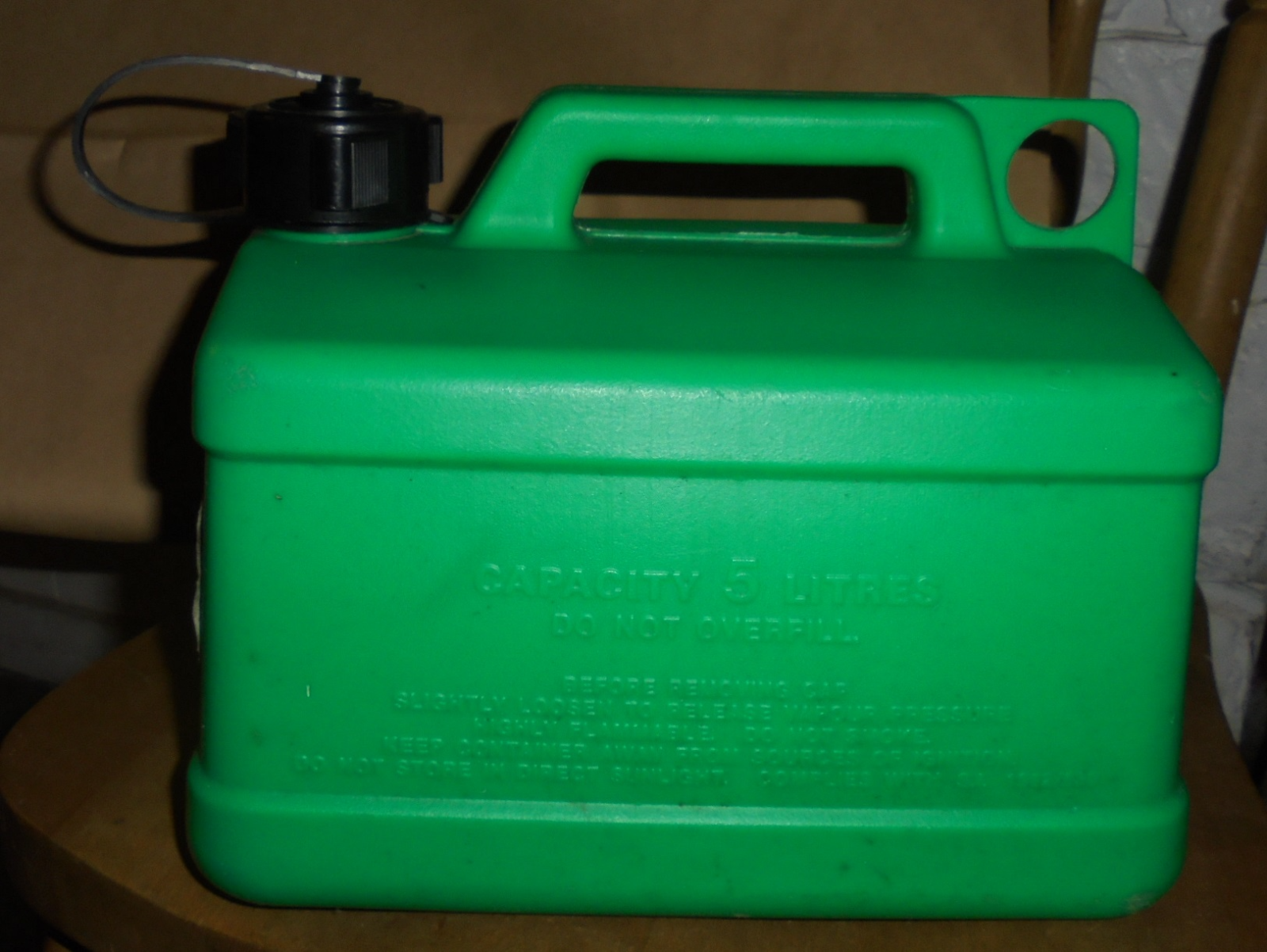

5 ish litres of Synergy Supreme+99 Unleaded for the BB Clio as hopefully a small assistance or placebo for the emissions re-test. Didn't note the price/litre but by the time I had filled the "can" to the brim the cost had comfortably passed £9.

5 litres of Esso Supreme+ 99 unleaded petrol poured into the tank

No the full 5l from the can, that was going to be point one of three things, but no doubt someone might have pointed out that an oil and filter change may be construed as 2 things! making four things in all!
Trying to be a good boy, you are not supposed to drive around to petrol stations when you have a failed MOT and the nearest is miles away. I'll shove a bit more in en route to the booked retest.
