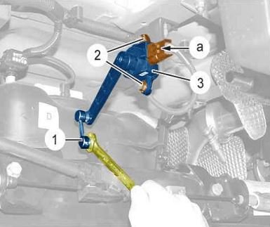

You'll probably find it is the height corrector at the rear that has corroded or gone faulty and needs replacing. The rear height corrector is a body height sensor that tells the suspension ECU what the rear height is so it can command the compressor to increase or decrease the height. When the data is invalid or intermittent it can cause the 'hunting' as it constantly tries to maintain the correct height.
The best thing is to get Citroen to confirm this and replace it for you. If the replacement corrector is not fitted correctly it can cause the height to be incorrect - so that's why I recommend a dealer to diagnose and replace if necessary.
You cans see the height sensor shown here at (3).
Don't get under the vehicle unless independently supported - risk of sudden dropping and crushing!
