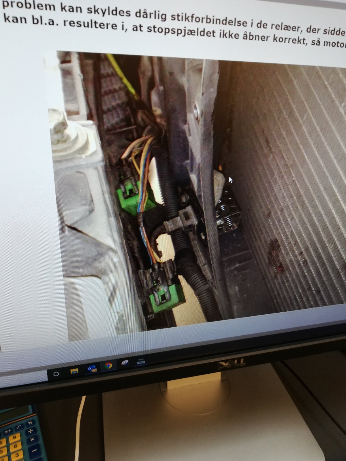

What are these two relays for? 206 Hdi and C3
I have been informed that these two relays can be the cause of a problem with the engine performance . My engine will not rev above 3000RPM and has very little power.
I have a photo of these two relays . It is I understand , of the peugeot 206 . They are also on the C3 I imagine.
The question is . What are these two relays function ?
Where are they situated on the Citroen C3?
The car is presenting the error code P0691 and P0693.
This is a cross model question as it is both 206 and C3 related.

Re: What are these two relays for? 206 Hdi and C3
Rad fan resitor relays ? Control fan speed Looks about that area
