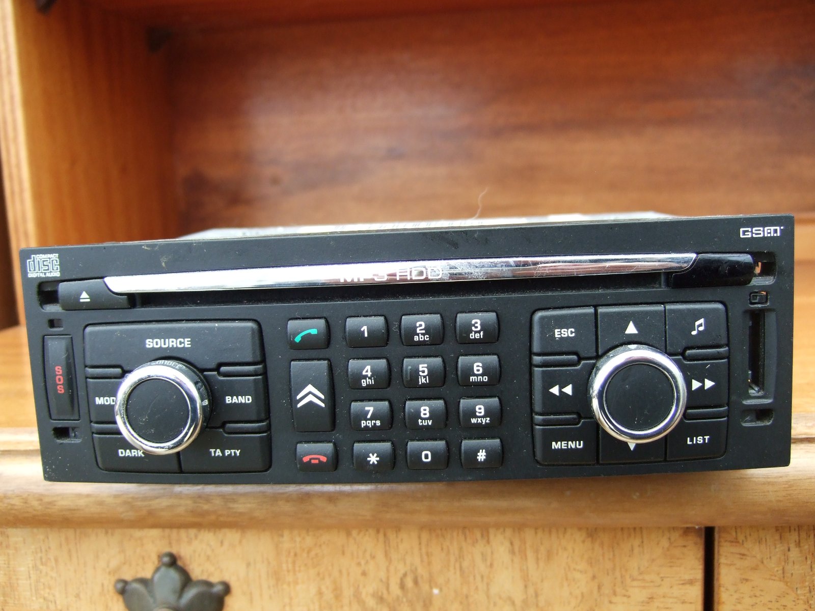

Radio No 96647951ZD. I have at great expense procured a replacement head unit, I excitedly connected it up only to be presented with the same symptoms as before.
No radio or satnav and a blank screen. On "normal" radios there is a red and a yellow lead for the power in, this one has a yellow which is permanently live as normal but the red lead which looks pink to me (ignition switched) and also has a push connector on it, has no voltage at all. I have checked and changed F8 which is labelled 'radio' and its OK of course.
I have tried feeding it with 12v from the yellow lead the only difference it makes is that you get a fleeting white bar on the screen when you turn the radio on and off. Have I missed something? I can't really believe that the new radio has the same fault as the old one.
Where do I go from here?

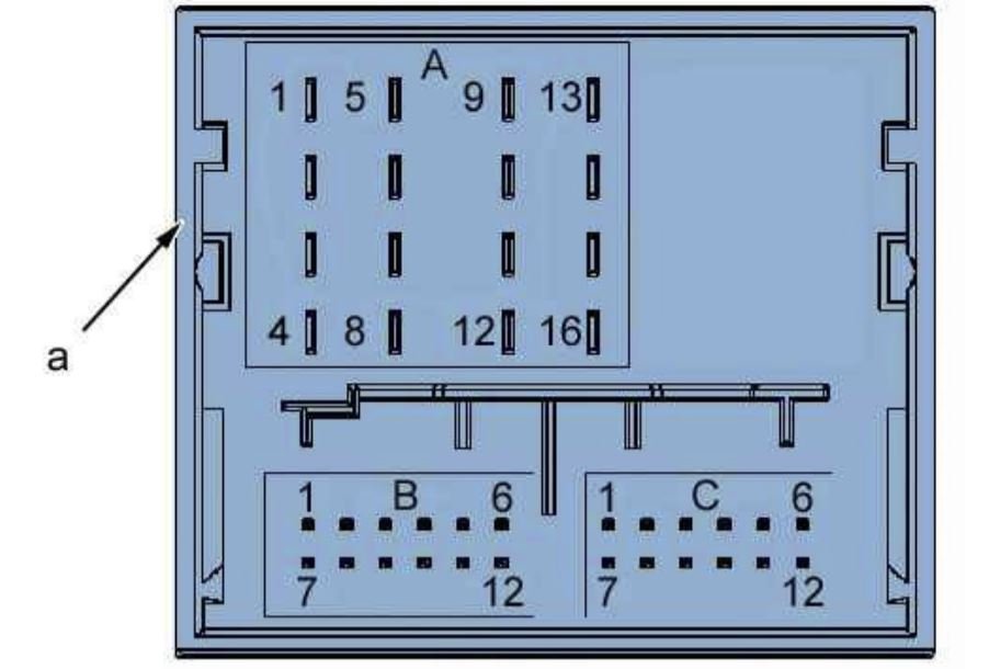

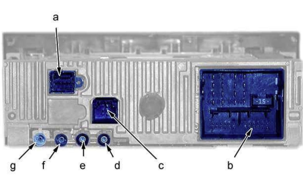

Have you considered that your screen may be faulty Peter? The screen is actually supplied by the RT4 via the quadlock connector (Part A 16 Track) on Pin 9 for the supply and the earth on Pin 15. It would be unlikely for 2 failed RT4 - units unless faulty, so it maybe that your screen is playing up especially given what you have said about the white streak. A word of caution here, always disconnect the quadlock connector first and reconnect last before unplugging any other connectors, especially the LVDS cable (top left in the picture) as this can damage the display. The LVDS is low voltage high speed to carry signals back and forth and is very sensitive.
"a" LVDS cable connector.
"b" 3-part connector.
"c" Connector USB (Unused: Service).
"d" GPS aerial .
"e" GSM aerial.
"f" Aerial FM2.
"g" Aerial FM1/AM.
"b" 3-part connector or Quadlock Connector.
Part "A" : Matching the 16 tracks
Part "B" : Matching the 12 tracks
Part "C" : Matching the 12 tracks
"d" GPS aerial .
"e" GSM aerial.
"f" Aerial FM2.
"g" Aerial FM1/AM.
| Channel n° Designation |
| 1 signal: Speaker (RH rear) |
| 2 signal: Speaker (Right hand front) |
| 3 signal: Speaker (Left hand front) |
| 4 signal: Speaker (Left hand rear) |
| 5 Earth: Speaker (RH rear) |
| 6 Earth: Speaker (Right hand front) |
| 7 Earth: Speaker (Left hand front) |
| 8 Earth: Speaker (Left hand rear) |
| 9 Supply: multifunction screen |
| 10 Comfort CAN High |
| 11 Not connected |
| 12 Battery supply |
| 13 Comfort CAN Low |
| 14 Not connected |
| 15 Earth: multifunction screen |
| 16 Earth |
| 1 Video input no 1 + |
| 2 Output - Telephone loudspeaker for emergency call |
| 3 Microphone input |
| 4 Input: Audio video socket (Right hand ) |
| 5 Screen backlighting signal |
| 6 Video input no 2 + (If connected) |
| 7 Video input no 1 - |
| 8 Output + Telephone loudspeaker for emergency call |
| 9 Supply: Microphone |
| 10 Input: Audio video socket (Left hand ) |
| 11 Reference signal: Audio video socket |
| 12 Video input no 2 - (If connected) |
| 1 Earth: CD player |
| 2 CAN Low CD changer |
| 3 Power supply through the RT4 of the CD changer |
| 4 CD changer right-hand audio |
| 5 Not connected |
| 6 CAN High steering wheel with fixed central controls control |
| 7 CAN High CD changer |
| 8 Reference signal: CD player |
| 9 Audio amplifier mute |
| 10 CD changer left-hand audio |
| 11 CAN Low steering wheel with fixed central controls control |
| 12 Emergency call request coming from the air bag ECU |

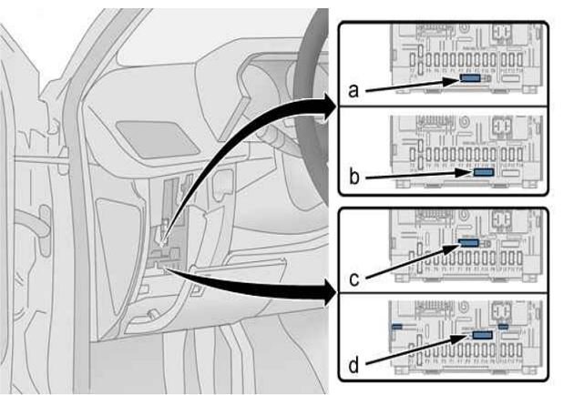

The BSI is the main brain of the vehicle, so care should be exercised Peter.
There is one other important check you should make before doing anything else in light of your recent post above:
It is possible that the SHUNT fuse has been located in the incorrect position for normal operation - in other words left in park mode for long term storage which disables certain electrical outputs to maintain the battery. If this has been pulled out at some point for checking and reinserted in the wrong location then that is likely to be your problem as the shunt park position will shut off power from the maxi fuse supplying power to F8 from the Engine Fuse Box. This may account for why there is no output from fuse F8.
You therefore need to double check the Shunt fuse is in the client / customer position.
Your BSI may be one of 2 fitted - Here is the diagram for both types and the relevant Shunt Positions:
It is important before removing and replacing the SHUNT fuse to follow the guidance:
The shunt positions below will depend on the layout of your BSI as per the diagram above.
- Switch off the ignition
- Wait 2 minutes for the BSI to switch to standby (don't open any doors or press any switches during this time)
- Remove the flap to access the fuses
- Remove the shunt from the park position ("a" or "c")
- Place the shunt in the customer position ("b" or "d")
- Press the shunt further in, to force it fully into its housing
- Refit the fuse access flap
- Check that the fuse access flap is flush
