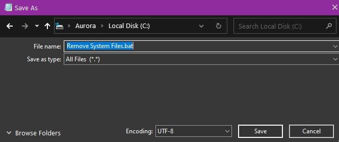

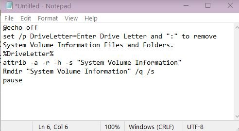

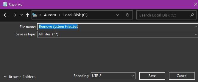

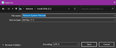

- x 6950
Re: Sat nav map update
You need to copy the text in the code window in my post.
You can do this by pressing the SELECT ALL option from the code window. This will copy the text to the windows clipboard.
Open Notepad on your PC
Paste the Code in.
It should look like this:
Then in Notepad, choose FILE, SAVE AS and then make sure the 'SAVE AS TYPE' dialogue box is set to ALL FILES (*.*) Just leave the ENCODING options as UTF-8, there's no need to change this.
Type the filename and save.
