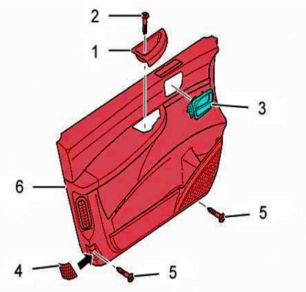

Door Card Remove:
- The (2) bolt
- The bezel (1)
- The interior door handle control (3)
- The reflector (4)
- The 2 bolts (5)
- The electrical control from the window lifter (Disconnect the connectors )
Remove the inner trim (6) (towards the top).

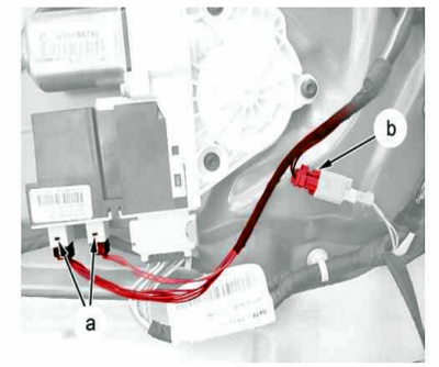

Mirror

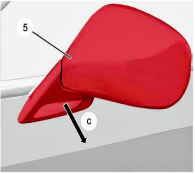

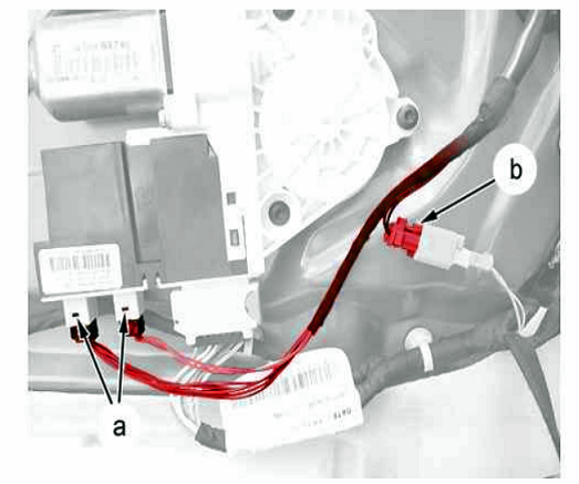

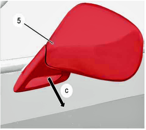

| Disconnect the connectors ( as "a", "b"). | Detach using trim removal tools:
| Remove the exterior rear view mirror (5) (In the direction of the arrow "c"). |
Proceed in the reverse order to removal.
Note: Take care with the routing of the electrical harness of the exterior rear view mirror (5).

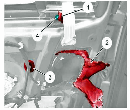

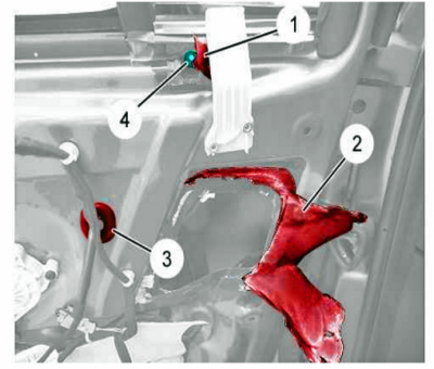

Tighten the nut (4) to 1.2 m.daN.
Note: Check that the exterior mirror works correctly before refitting the door trim pad and always replace the adhesive pad (1) and the sealing sheet (2) if they are damaged.
