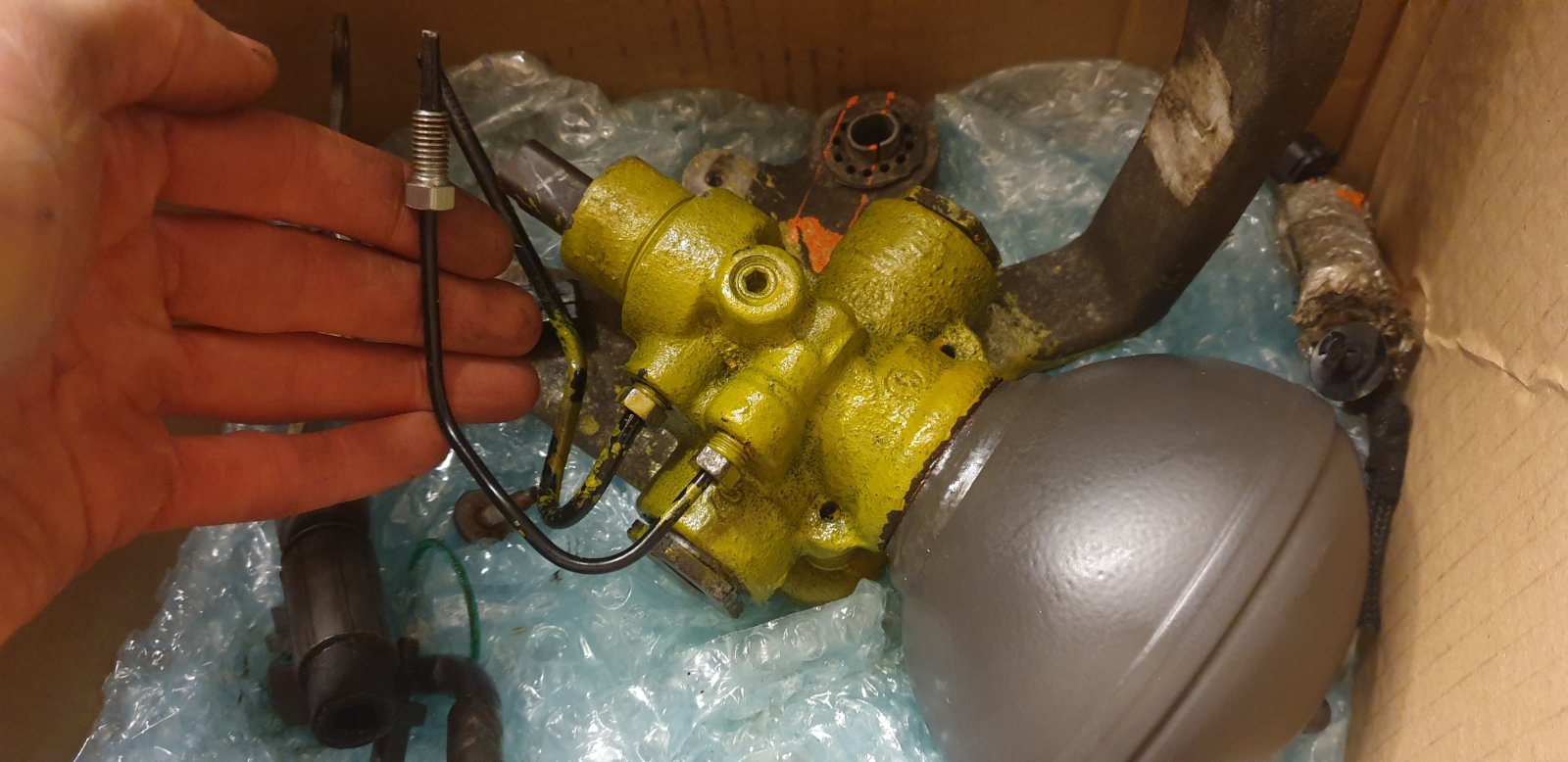

Here's a pic of the front regulator in it's nice rusty state. I found out to my dismay that although the previous owner told me the long front to rear hydraulic pipe was replaced and I'd seen the nice copper nickel pipe at the rear. I can't see it at the front and indeed the pipe as it connects to the BHI unit is black coloured. This means that they must have joined it somewhere amidships.... My plan was to replace it completely but speaking to Pleiades they tell me they currently cannot make C5 pipes up because of a shortage of the ends. I did get a cut-off pipe with that new front regulator so I thought I'd see if it would take an LHM era pipe end form - and I've got the former- so here's a little trial. Initially I was using the cut pipes to plug the ports for painting until trying this. I'm thinking of simply doing this to either end and getting a length of 3.5 Cupro - Nickel pipe and standard Citroen straight joiners. I think someone (maybe Kenny) did this too? I've heard of some people using compression olives but since I have the old style pipe former I think I'll use that..
Here's what I'm dealing with at the rear: You can see the copper pipe from the union at the lower right. The regulator and rear suspension pipes are very rusty - I'd quickly painted them in black hammerite to try and slow the inevitable and get through this winter - it's hard to see how it passed last year's MOT.. this is what I intend to fix with those replacement rear pipes. Also, anyone know what the black plastic pyramid thing near the anti roll bar is?
Graeme M

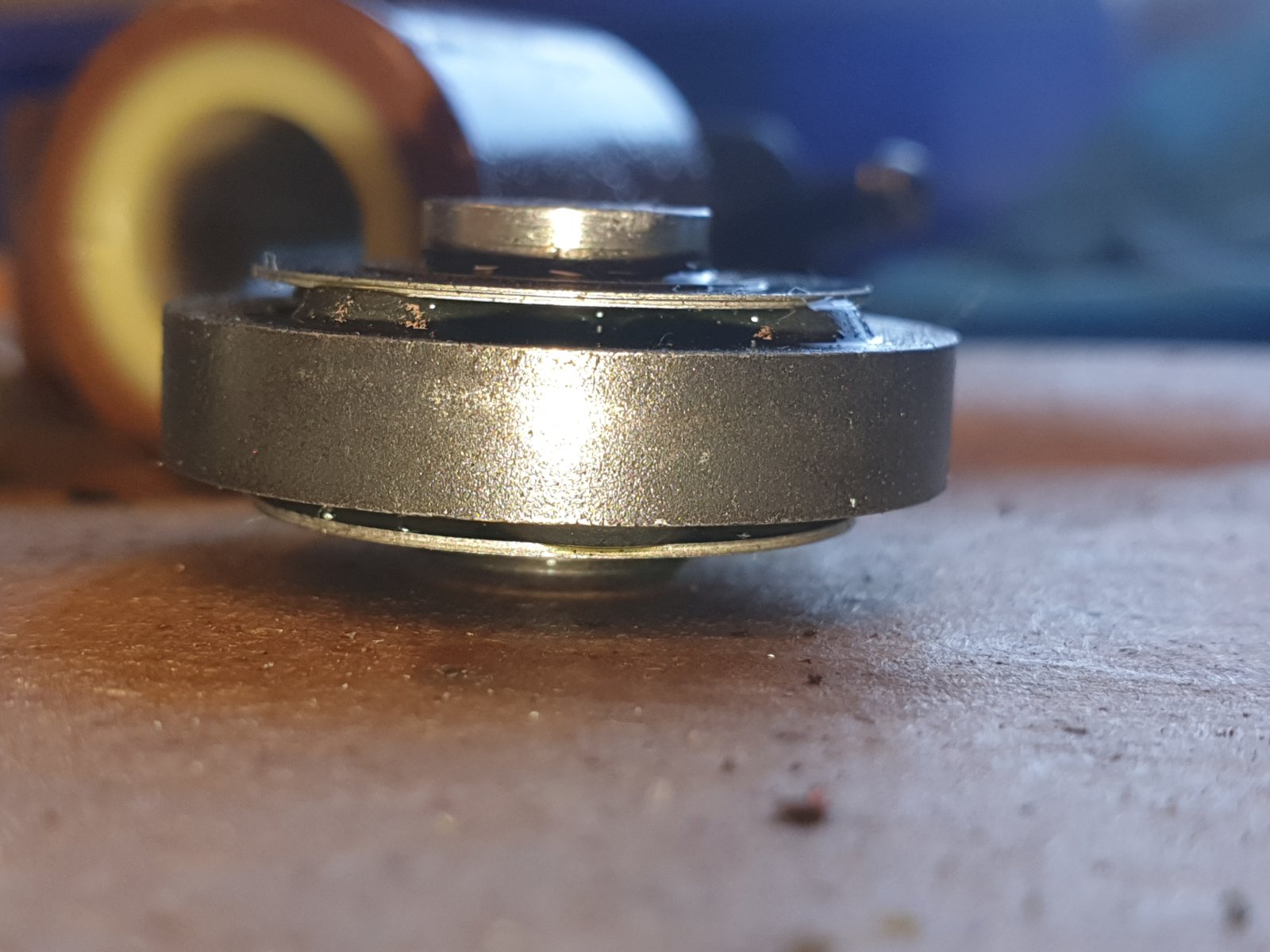

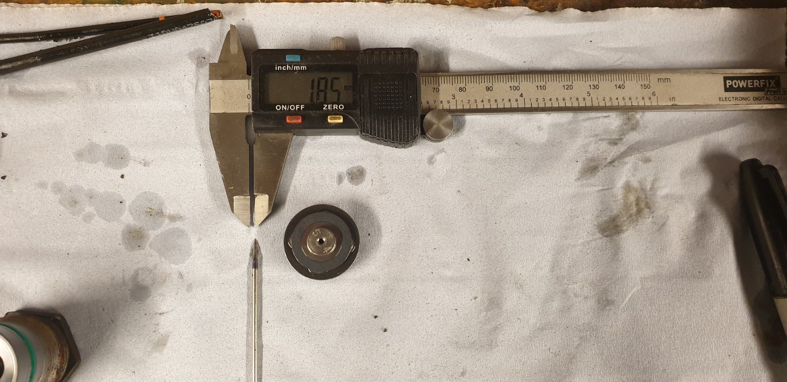

Few details about the front regulator:
The C5 Front H3+ firmness regulator damper center hole seems to be about 1.8mm, the rivet is etched with 5 - 4. It looked visibly larger than 1.8mm but could have been an illusion. Compared to the 1.3, 1.25 ( if I recall ) on the Xantia Hydractive rear and front firmness regulators this would be a lot different. I think the Xantia ones were etched with '2 - 6'.
Of course it depends on the actual volume of fluid moved for a given vertical stroke of the suspension cylinder.
Graeme M
