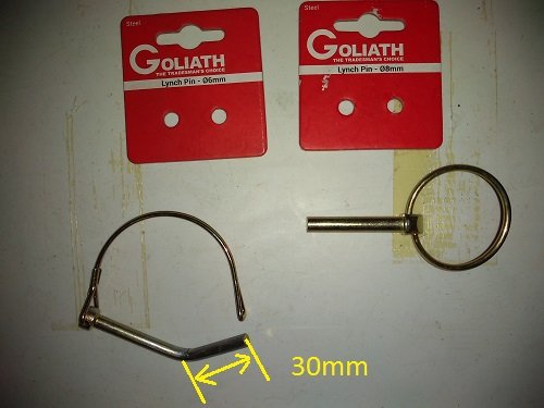

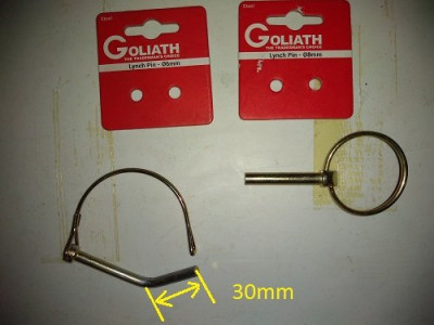

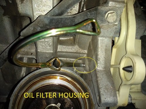

ozvtr
- Posts: 907
- Joined: 13 Oct 2020, 01:11
- x 255
Re: Setting timing from scratch
This is a picture of a TU3 engine but the TU5 is much the same (as far as "pinning the flywheel" goes).
I use linch pins. The 6mm pin needs to be 30mm long in the inserted part. If you make it too short it wont engage in the flywheel. If you make it too long it will foul on the casting webbing when you try to insert it.
