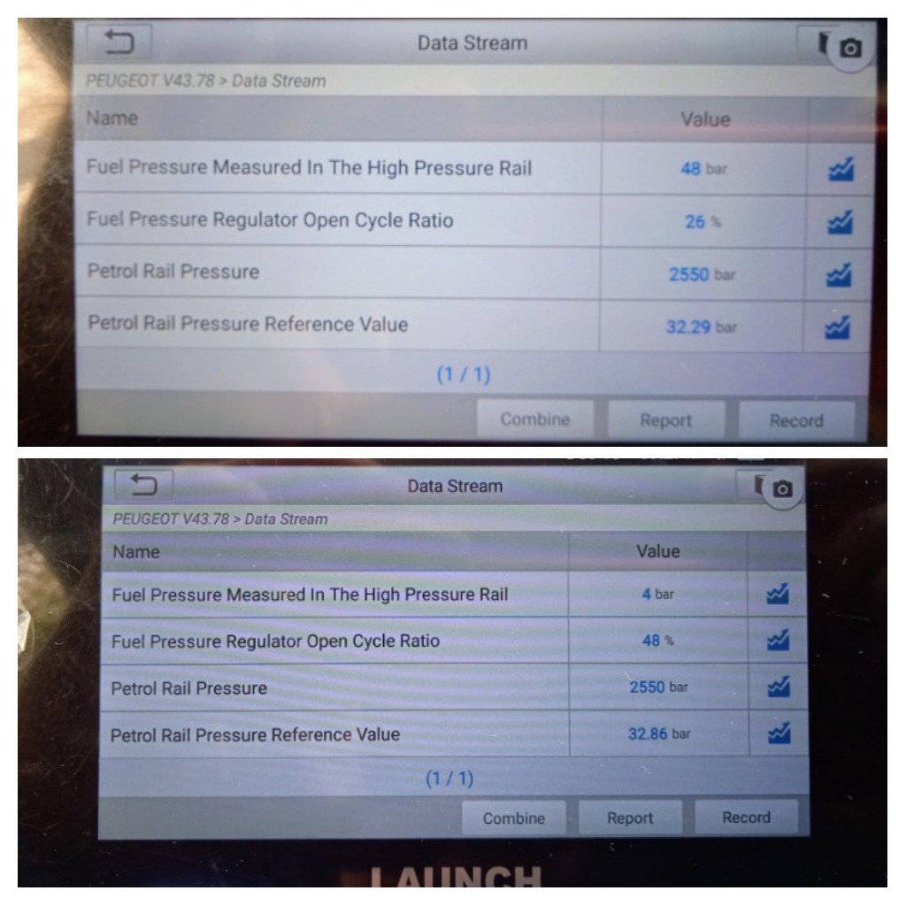

This is the read of the abovesaid

Re: P0087 1.6 thp 156bhp (Peugeot 508)
No, the fuel line from the tank has a connection and Schrader valve near the top engine mount (at least that's where it is on a 308). From memory, the pressure from the tank pump should be 5 bar. There is no sensor on this line, so an external gauge is required. Maybe you see this pressure at the high pressure sensor before starting the engine.
Before starting the engine there is indeed a pressure of 4-5 at the high pressure value
