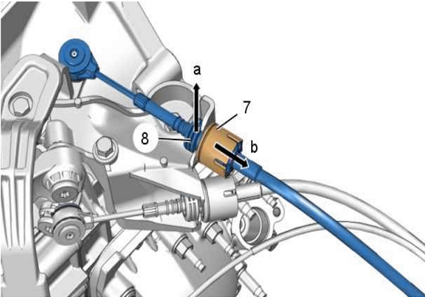

Re: Dispatch stiff gears
I meant the cylinder (7) - which acts as the lock. The sleeve stop (8) is just wedged into the bracket to keep it in place as it's pulled. This is on the 6 speed box which I assume you have.
Yes I think I did everything right, you pull part 7 back to get the cable on and off the bracket and then make sure its forward again to lock it to the bracket. Our van is a 5 speed but it looks exactly the same as your picture.
