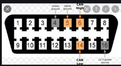

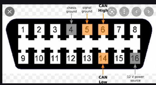

Try the pins in this diagram

Pin 6 can high
Pin 14 can low

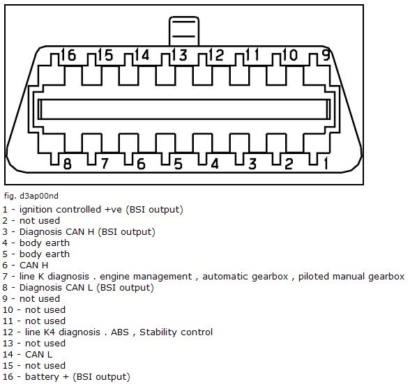

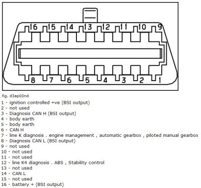

Here is the diagram of the OBD socket specific to a Full CAN C2.
Some options may not be present.
I suspect you wont have the ignition controlled live at pin 1 as this is provided by the BSI.

Is this voltage tested between pins 5 & 6 and 5 & 14?
