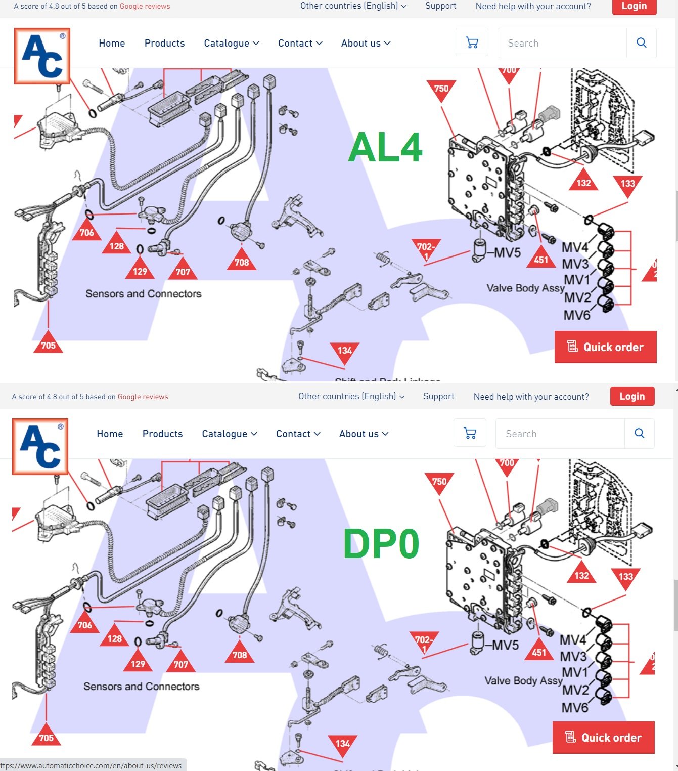

NewcastleFalcon wrote: 11 Dec 2021, 11:15 Seems like the Renault DP0 could well be the same as the AL4 Gearbox in Peugeot/Citroen. Can't be sure.
The firm Automatic Choice have pretty comprehensive catalogues of repair parts for auto gearboxes.
Their two pages for AL4 and DP0 boxes are identical, plus the technical advice here also covers both
https://www.automaticchoice.com/uploads ... AL4_TT.pdf
Automatic Choice website https://www.automaticchoice.com/en/search?q=DP0
