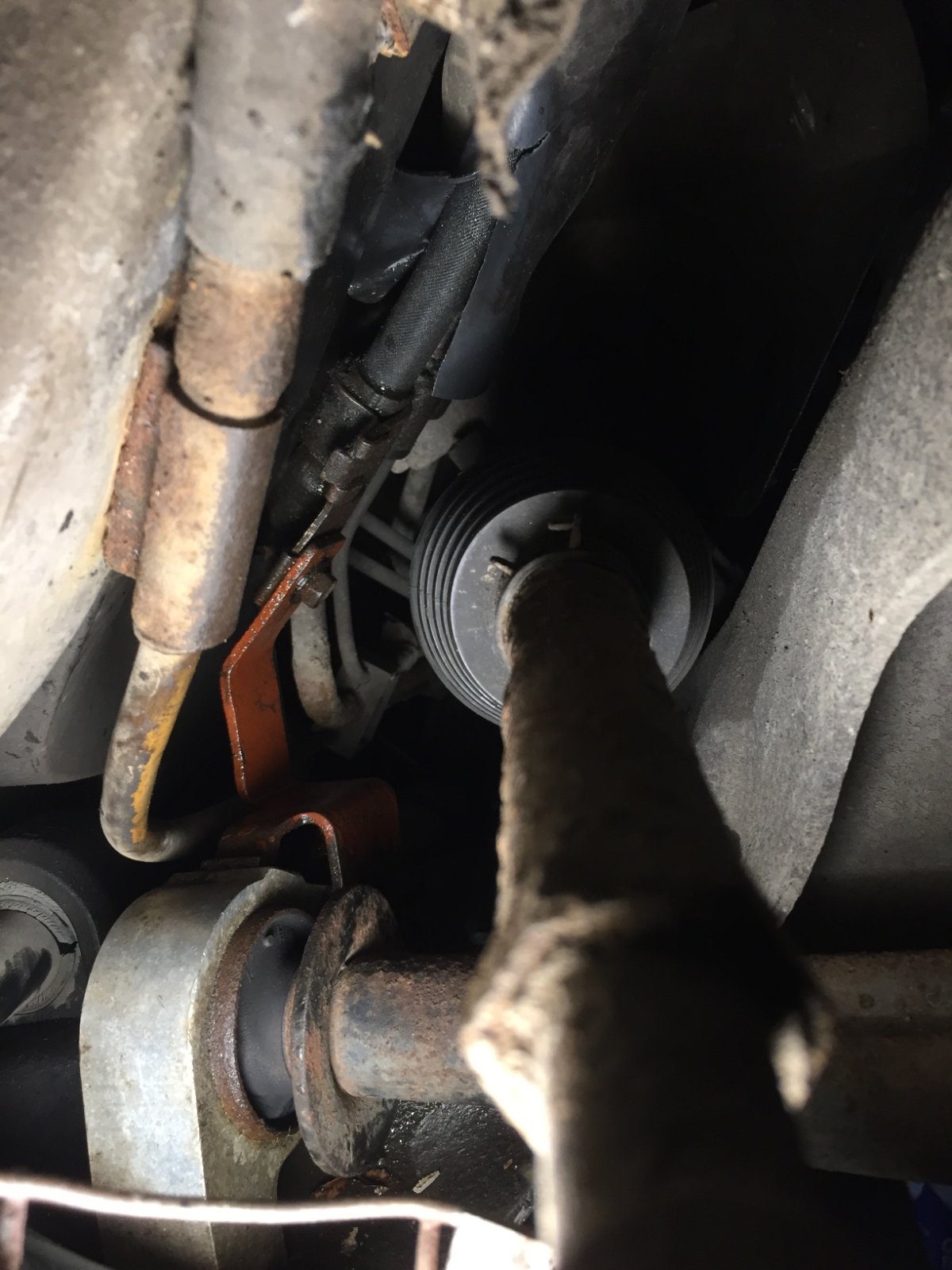

Leak appears to be coming from the lower crimped join....see photos.
Does ayone know what pipes these are, and is this a known fault ?
As suggestions to replair it without removing the engine.... [-o<
View looking along offside track-rod

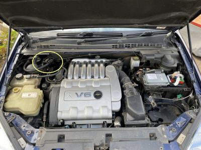

Not my car, but a good photo...

Is this a 3+ system (with sport button)?. If its the main pipe harness i think it is then yes its quite a common failure but its a horrible job to change. The easiest way is to drop the front subframe.
