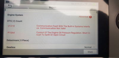

Dear all ,
Can any one help or has this fault come up .
I scan my car and this code come up p15A4 is c4 grand picasso 2016
Fault Code p15A4

Hi and
That is a new one on me and there are many more knowledgeable members who may be able to help, but my thoughts would be to check the connecting plug on the oil pressure sensor for dirt or broken wires. Accumulation of oil based dirt around the plug may cause it to short circuit so be sure it is cleaned properly. Good luck!
