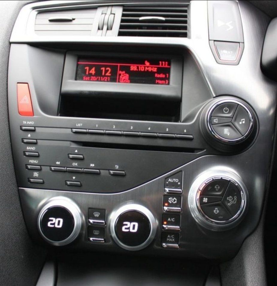

Sorry everyone I'm not an expert... is this valid just for who has the two unit above mentioned? I have this one in my car and I would like to know if can be changed with something else?
I have attached the photo no idea what model is I cannot even find on Internet.

It is an RD45 radio you've got, with monochrome display.
It can be replaced with other head units that were fitted in DS5. Makes most sense to swap it with the latest one, called NAC (Navigation Connectée) that was built-in for last 2 years of DS5 production.
It can be done DIY, but if you're "no expert" maybe best to have it done by a specialist? There is one in UK (Magpieautos.com) and you can look it up. Prices go from £450.00.
More details on the conversion you can find in this topic: viewtopic.php?t=69891. Apart from described there (it is for RT6) in your case it'll be a generic GPS antenna needed, as well as (maybe) 3 wires tweaking to feed the new display (the ones from the monocrome display probably won't work). If you have the reversing camera it will work with NAC without any modifications. If you don't have it - the OEM one can be added.
And there are some Android head units that can also be fitted instead of your current radio.

thanks MacSlavko... so can be just upgraded but not swapped with different units like pioneer or similar 🤔
x 6957
Re: DS5 Radio Replacement
Not really that's old school now and why there aren't as many on the market that there once was - due to heavy integration of the vehicle systems into the head units on PSA cars and many other manufacturers too.
You will likely lose visual Parking assistance (if fitted) and the ability to configure vehicle options, computer functionality for example.
The best upgrade paths are within compatible existing PSA systems.
What ever you decide, the units will need configuring with diagnostic equipment to code the VIN and also the other telematic options. You will also need to upgrade the aerial to ensure they are GPS enabled, sort out microphone and wiring and possibly configure the instrument panel ECU too. It's not as straight forward going from a basic RD45 system as it is from an existing telematics to another telematics system, as there are more requirements.
