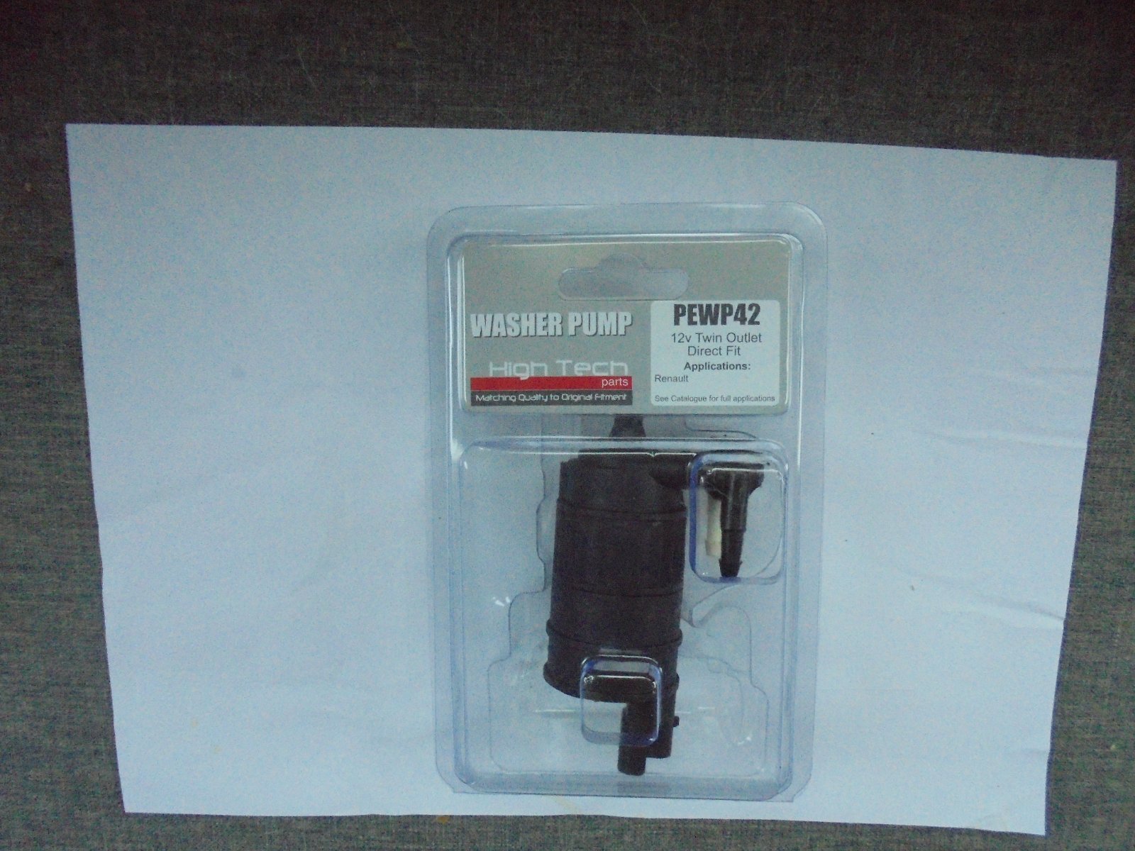

Just done this little job, and the washers are back working again.
The new washer motor was under £10 from eurocarparts, but as ever there were a few little difficulties to overcome.
To access the washer reservoir the two plastic scuttle panels under the windscreen have to be removed, drivers side first, then passenger side.
The passenger side does require removal of the windscreen wipers, which I discovered were stubbornly solidly attached to the splines of the wiper linkage. I only had wd40 available to help with the dismantling, plus gas would have been much better, but the 15 minute job turned into 2 hours by the time the wipers eventually popped off.
I also found the single 10mm bolt which holds the washer reservoir was also inaccessible to my sockets due to the wiper linkages getting in the way, and a short 10mm spanner was the best I had to undo it probably less than 1/8th of a turn at a time! Good job I had 2 cos spanner No1 decided to drop down the scuttle tray and proceed to disappear to an inaccessible point, and remains there now.
Replaced the motor without actually fully removing the reservoir, because it was getting late and the method of manoeuvring the reservoir to get it out of he scuttle tray past the wiper linkages evaded me, and it just didn't come out. I certaily didnt want to move the linkages from the park position, or remove the wiper linkages to get it out.
The motor was easily enough replaced even without fully removing the reservoir. It just pokes into a hole at the front of the reservoir after inserting a rubber sealing grommet wich comes with the motor.
Nice to have done the job and got it working again.
