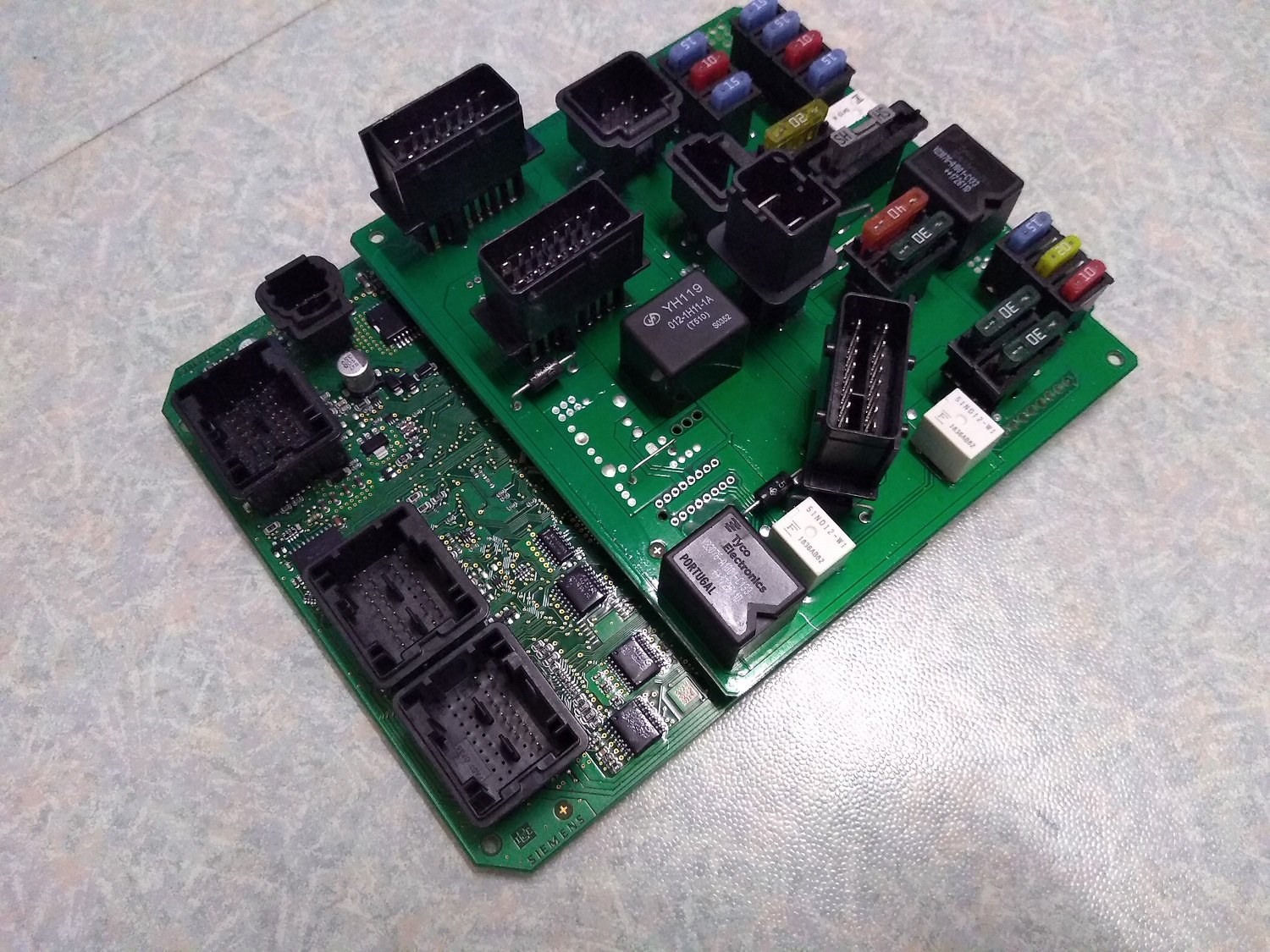

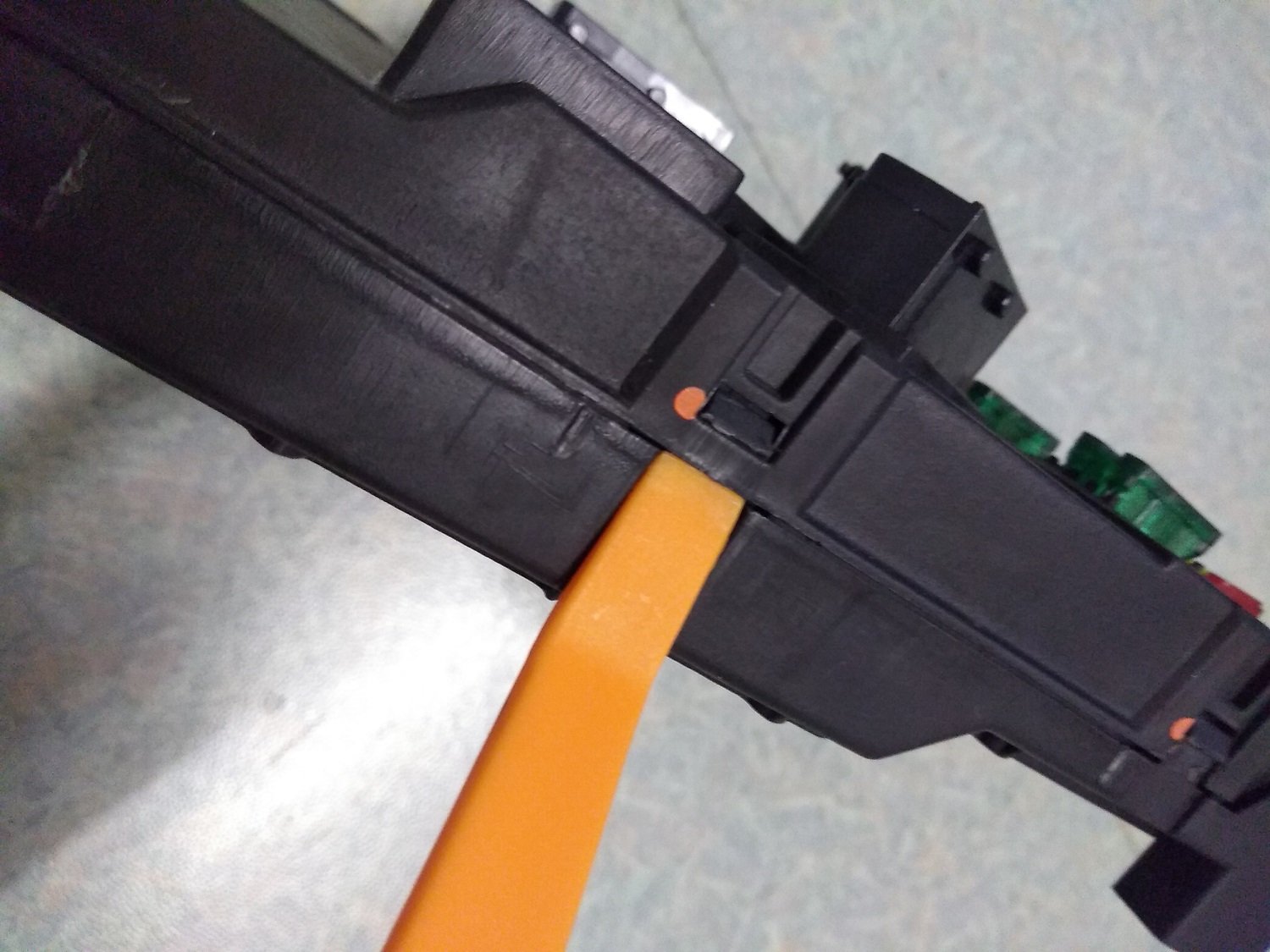

napping wrote: 04 Dec 2021, 13:03 Checked the earths on green connector for pins 6 & 8 and they are fine. Tried setting the multimeter to 10adc to check the current on pin 8 and got zero when ignition is off and 0.01 when ignition is on.
The next step would be to open up the BSI.
How far down this rabbit hole do you want to go?
You can pry the tabs to release the two halves. Be very careful not to break the tabs!! You will need to run a blade through the paper label. This is a photo of the guts of a MK1 BSI. Yours will be similar but not exactly the same. You will need to go over it with a fine tooth comb. Look for any kind of anomalies, things that don't look right. Anything burnt out.
Failing that, you may need to send it away for repair.
