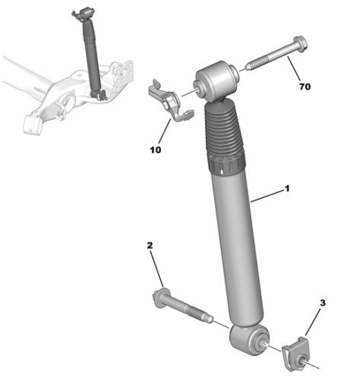

Have got the rusty bottom bolts to finally move so that I can swap the shock absorbers. Should the rubber gaiter be fastened to the top of the shock so that the piston rod isn't visible?
-Andy.
x 6956
Re: Peugeot 207 rear end clunk - what to check?
Like this Andy:

Unread post by randomandy »
Hi Marc,
What is the item marked "3"? When I replaced the shocks that didn't look to be a removable part although that could just be the fact that it is rusted in place. Had to get bolt "2" out using the E-16 socket and a piece of scaffold to extend the length of my ratchet handle - maybe Santa will bring be an impact wrench for Christmas!

x 6956
I’ve only just seen your question 2 posts above.
Item 3 is a securing nut, but is not shown as being fitted on your vehicle, so you may have a different type of fixing if it is not there.
