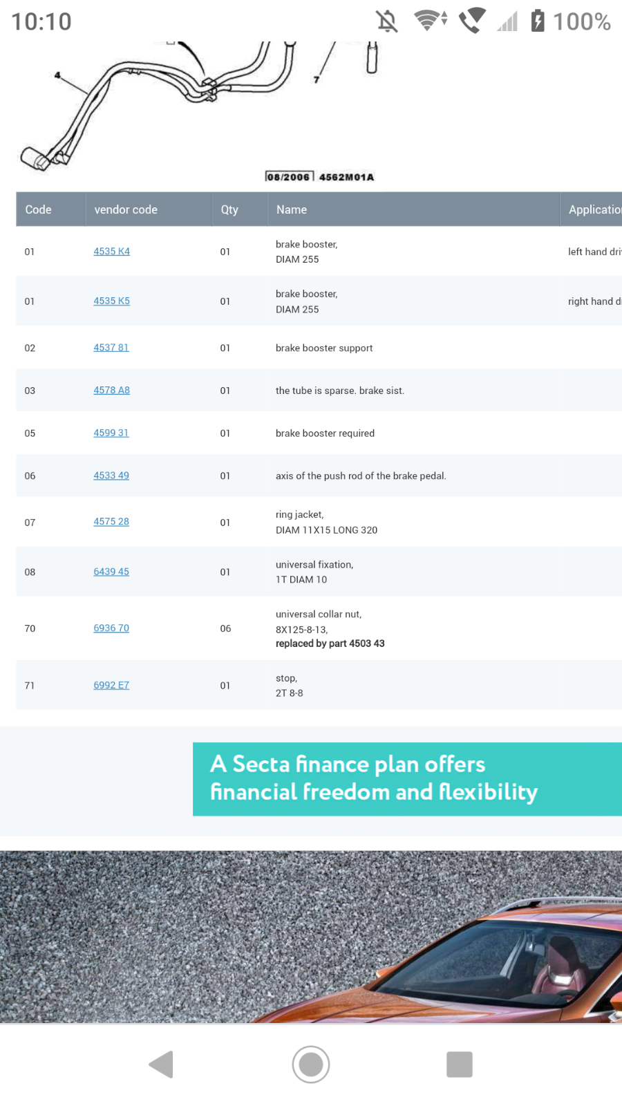

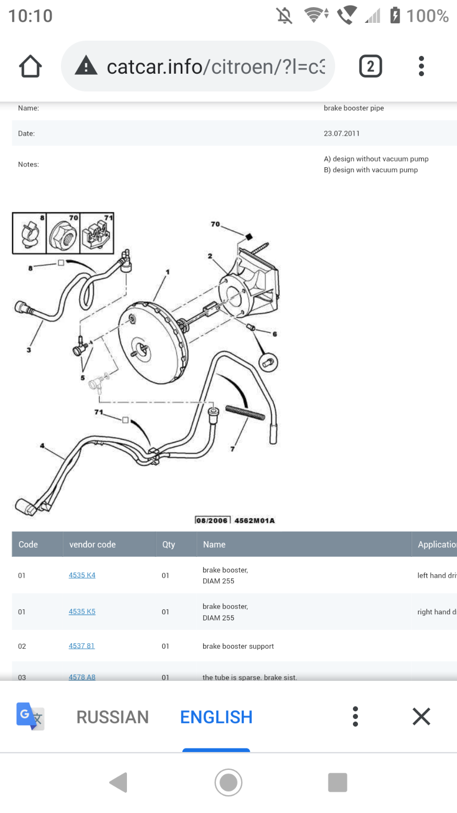

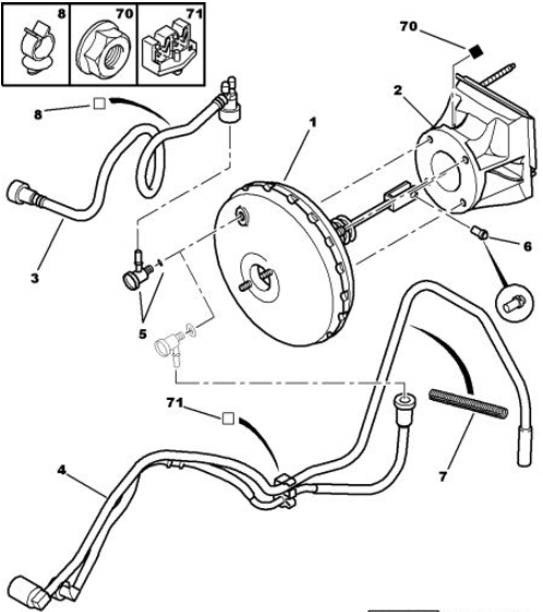

Well, I need to find out about a part for my C5. The engine is now running on all four cylinders (YAY!!!), but it seems that the vacuum pipe that goes from the vacuum pump to the servo is damaged at one end (the clip isn't latching properly). Are these still available from Citroen, what is the part number and cost? Thanks.

Looks like it.. But I can't tell you NFP or not..

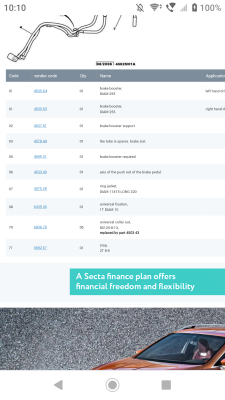

The amplifier kit is available (5), but not the brake hose (3) and you don't have (4).
